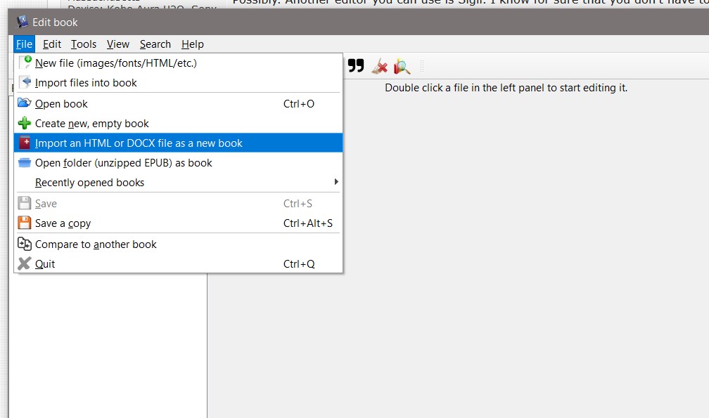

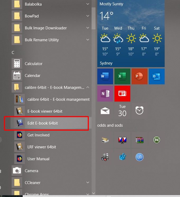

You can use the calibre Book Editor independently of Library Management
On Windows you can get at it via the Start panel, viz:

And from there you can import an HTML file

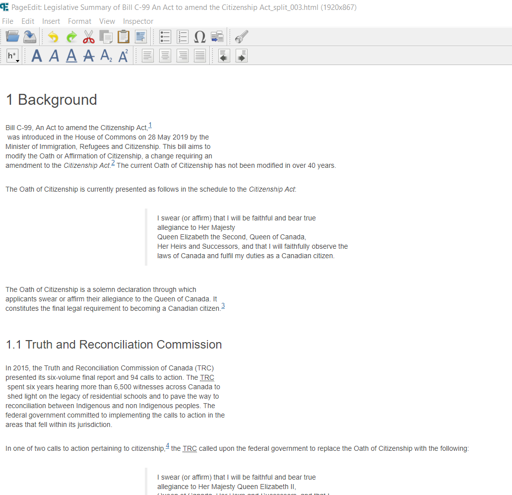

Originally Posted by MistaPrime View Post
Indeed, I was planning on adding a stylesheet/CSS to Calibre's custom CSS option.
Thanks for your suggestion, I appreciate that.
You're welcome.
The HTML above was found by Googling "footnote styles", I frankly didn't even notice it was from a Gov site but that does prove a bigger point, that even larger sites do not use <sup> in their HTML.
Very likely because their programmers understand the use of cascading style sheets and how useful they are to replace endless in-line styles -- you did notice the 3 stylesheets linked at the start of the HTML snippet? Anytime you want consistency between segments of your site when multiple people are maintaining it, common stylesheets are among your best friends. Yes, you can use inline styles, you can declare styles at the start of every HTML file but anyone who uses those techniques instead of a linked stylesheet is living in the '80s.
If you had downloaded the stylesheets associated with that page and placed them in the HTML archive, the footnote class would have been preserved and used.
Edit: I tested this by using Firefox's Save Page As on Legislative Summary of Bill C-99: An Act to amend the Citizenship Act, saving the result as a .zip file which I imported into calibre and then converted to epub. See the snippet of the epub open in PageEdit attached as an image. Notice the footnotes references are superscripted. The exact stylesheet structure was not preserved due to calibre's love of flattening stylesheets but the intent was preserved.

Oh and since you seem to be determined to argue for the sake of arguing, here is how you actually fix your problem, which IIRC was to get superscripts to display aligned. Add the following to the extra CSS option in the calibre conversion options under Look & feel
.footnote { vertical-align: super }
and magic! your footnotes will be vertically aligned.
