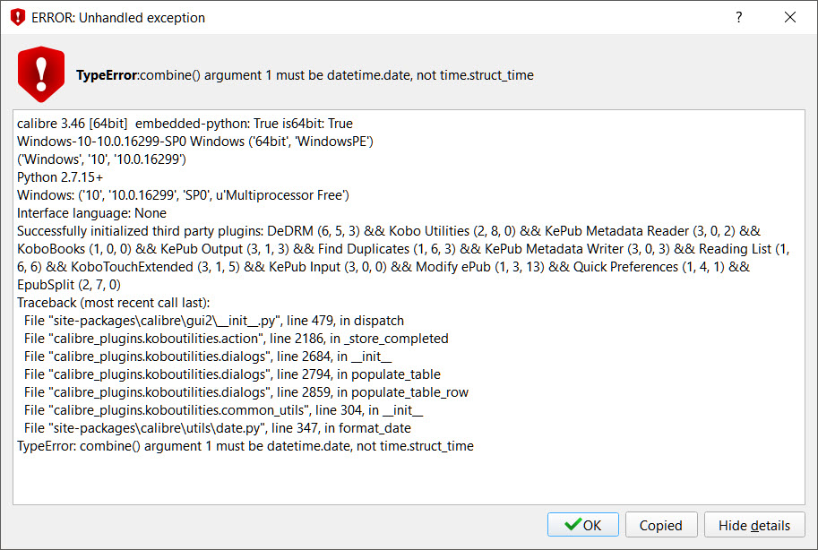

Hello,
Recently, whenever I plug in the Aura One, at the end of the ""storing reading position for … books" I receive the following error.
calibre, version 3.46.0
ERROR: Unhandled exception: <b>TypeError</b>:combine() argument 1 must be datetime.date, not time.struct_time
calibre 3.46 [64bit] embedded-python: True is64bit: True
Windows-10-10.0.16299-SP0 Windows ('64bit', 'WindowsPE')
('Windows', '10', '10.0.16299')
Python 2.7.15+
Windows: ('10', '10.0.16299', 'SP0', u'Multiprocessor Free')
Interface language: None
Successfully initialized third party plugins: DeDRM (6, 5, 3) && Kobo Utilities (2, 8, 0) && KePub Metadata Reader (3, 0, 2) && KoboBooks (1, 0, 0) && KePub Output (3, 1, 3) && Find Duplicates (1, 6, 3) && KePub Metadata Writer (3, 0, 3) && Reading List (1, 6, 6) && KoboTouchExtended (3, 1, 5) && KePub Input (3, 0, 0) && Modify ePub (1, 3, 13) && Quick Preferences (1, 4, 1) && EpubSplit (2, 7, 0)
File "site-packages\calibre\gui2\__init__.py", line 479, in dispatch
File "calibre_plugins.koboutilities.action", line 2186, in _store_completed
File "calibre_plugins.koboutilities.dialogs", line 2684, in __init__
File "calibre_plugins.koboutilities.dialogs", line 2794, in populate_table
File "calibre_plugins.koboutilities.dialogs", line 2859, in populate_table_row
File "calibre_plugins.koboutilities.common_utils", line 304, in __init__
File "site-packages\calibre\utils\date.py", line 347, in format_date
TypeError: combine() argument 1 must be datetime.date, not time.struct_time
I think it's being caused by the Koboutilites plugin. If so, does anyone have any suggestion to fix it?
Thank you in advance for the help.

Old 07-21-2019, 10:56 AM   #1629
davidfor
Posts: 24,905
Karma: 47303828
Location: Sydney, Australia
Originally Posted by Kobber View Post
Hello,
Python 2.7.15+
Yes, that is coming from the plugin. One of the dates on the device isn't in the expected format. Can you run calibre in debug mode and try again? Then post the debug log. Hopefully the logging will show the date that is failing a conversion.
davidfor is offline
Python 2.7.15+
Successfully initialized third party plugins: DeDRM (6, 5, 3) && Modify ePub (1, 3, 13) && KoboTouchExtended (3, 1, 5) && KePub Metadata Reader (3, 0, 2) && KoboBooks (1, 0, 0) && Quick Preferences (1, 4, 1) && KePub Output (3, 1, 3) && Find Duplicates (1, 6, 3) && Kobo Utilities (2, 8, 0) && KePub Metadata Writer (3, 0, 3) && KePub Input (3, 0, 0) && EpubSplit (2, 7, 0) && Reading List (1, 6, 6)
Job: 4 Storing reading positions for 2509 books finished
No details available.
Hello.
I tried reverting Calibre to a version when I know the plugin was working, but to no avail.
Is there somewhere I can retrieve older versions of the plugin to determine which previous instance might work?
I doubt that any version of calibre or the plugin will work. The issue is a date on the device is not in the expected format. And there have been no changes in the code for handling dates for years. In fact, this has probably always been a problem, but, it has never been triggered as the dates have always been valid. I will fix this, but it will probably be the weekend before I can.
Looking through the log, the problem looks to be an annotation on the book "Apt Pupil". Instead of an actual timestamp for when the book was last read, it has the words "CURRENT_TIMESTAMP". Marking the book as read or unread, or opening it again will probably fix the problem.
davidfor is offline
That did it!
Thank you very much. Once you pointed out the error, I noticed there was a second book showing "CURRENT_TIMESTAMP" instead of the date, and marking them both as read from the kobo, as you suggested, fixed the issue.
Thank you again for your help, I much appreciate it, and please don't do any extra work on the plugin on my behalf, I'm happy now.
