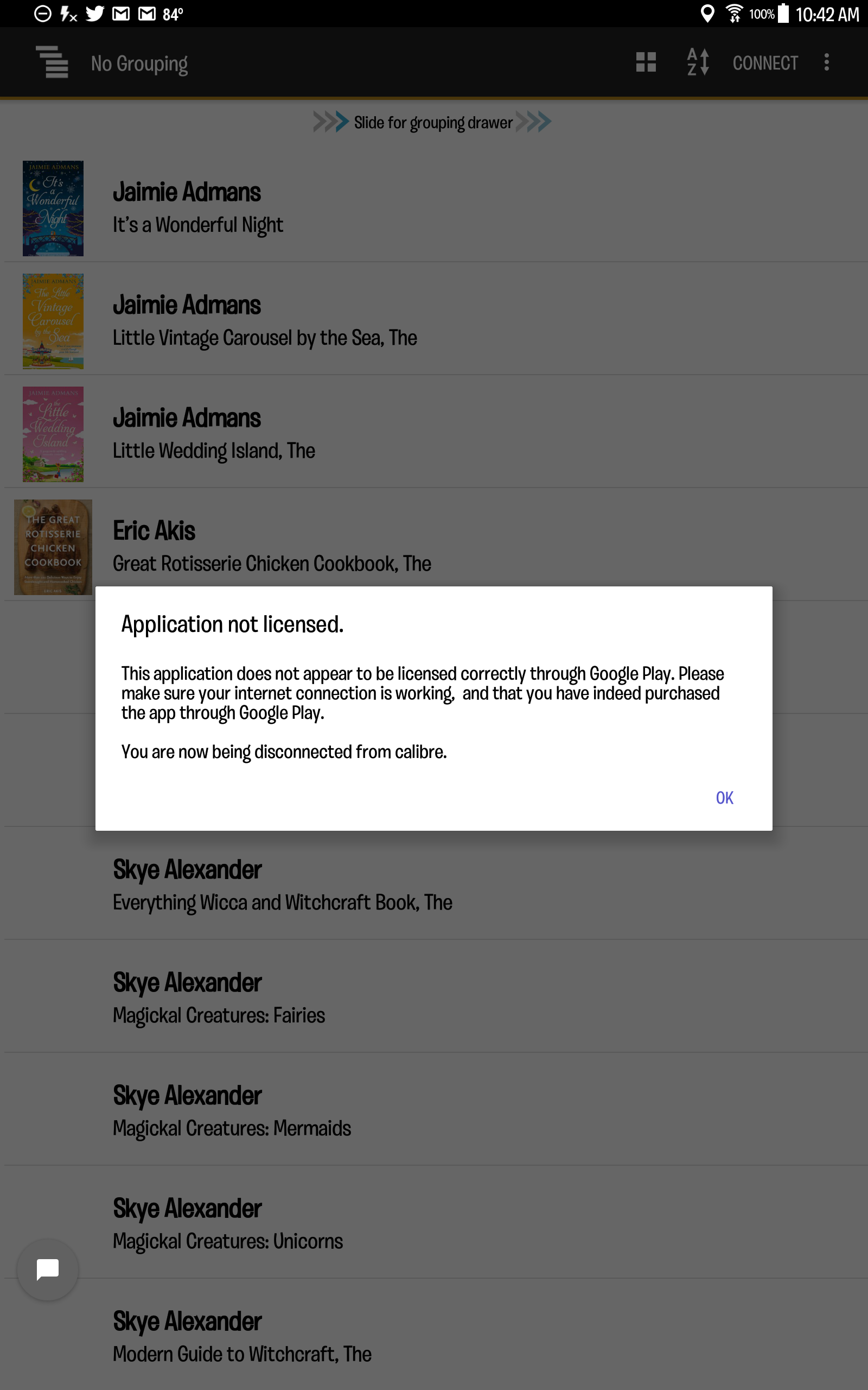

Ok...so I made the suggested changes and now I get this in the app! I set it back to default in calibre and still getting this error!
I uninstalled the app and am reinstalling it now. I deleted all books off the device. I am going to try a clean start and see what happens.
EDIT: I reinstalled the app and it will connect to calibre now. I did connect to the content server with the tablet's mobile browser and it scrolls well past the point CC stops. So this has to be a CC error, right? IDK...I am so confused!
EDIT 2: I am in the process of moving all of the books tagged under the tag where I originally found the error. I am moving them to their own library to see if this fixes the main library. I will let you know if it works.
I confess to being confused about what you are doing. The above error can happen only during a wireless device connection, not a content server connection. Which one are you doing?
Connect using which connection type? And no, that doesn't demonstrate that it is a CC error. CC used the "OPDS" service of the content server, which is totally different from the mobile service.
