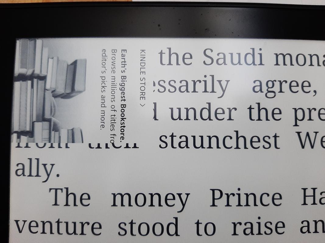

That's pretty much going to be a case of "pics or it didn't happen", because I have no idea what you might be talking about .
Sorry if the pic is big, still adjusting to a new phone...

Is this a Special Offers device? Do you have the ScreenSavers hack installed? Do you usually read in Landscape (or Inverted Portrait, if that's possible on your device)?

Possibly a quirk because you're reading in Landscape.
I know it can cause weird little glitches in some very specific circumstances. Weird that those would be exposed on a vanilla device, but, eh.

You must be trying to use the factory's "Q. and A. firmware".
Install a consumer firmware from the Amazon server.
Go to your product page, select the "update" link, edit the version number to pick the version you want (all updates are present on the Amazon server(s))
Edit:
That "store" panel looks a lot like a "Special Offers" panel.
