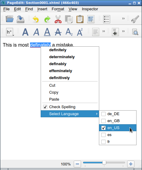

Since you rebuilt from master, can I ask if the new spell-check feature of PageEdit is working? You may have to actually click in the editor Window for it to start underlining words, but I'm curious.
It works fine for the bundled languages. Thanks for adding this very useful feature!

spellcheck works for me also.
