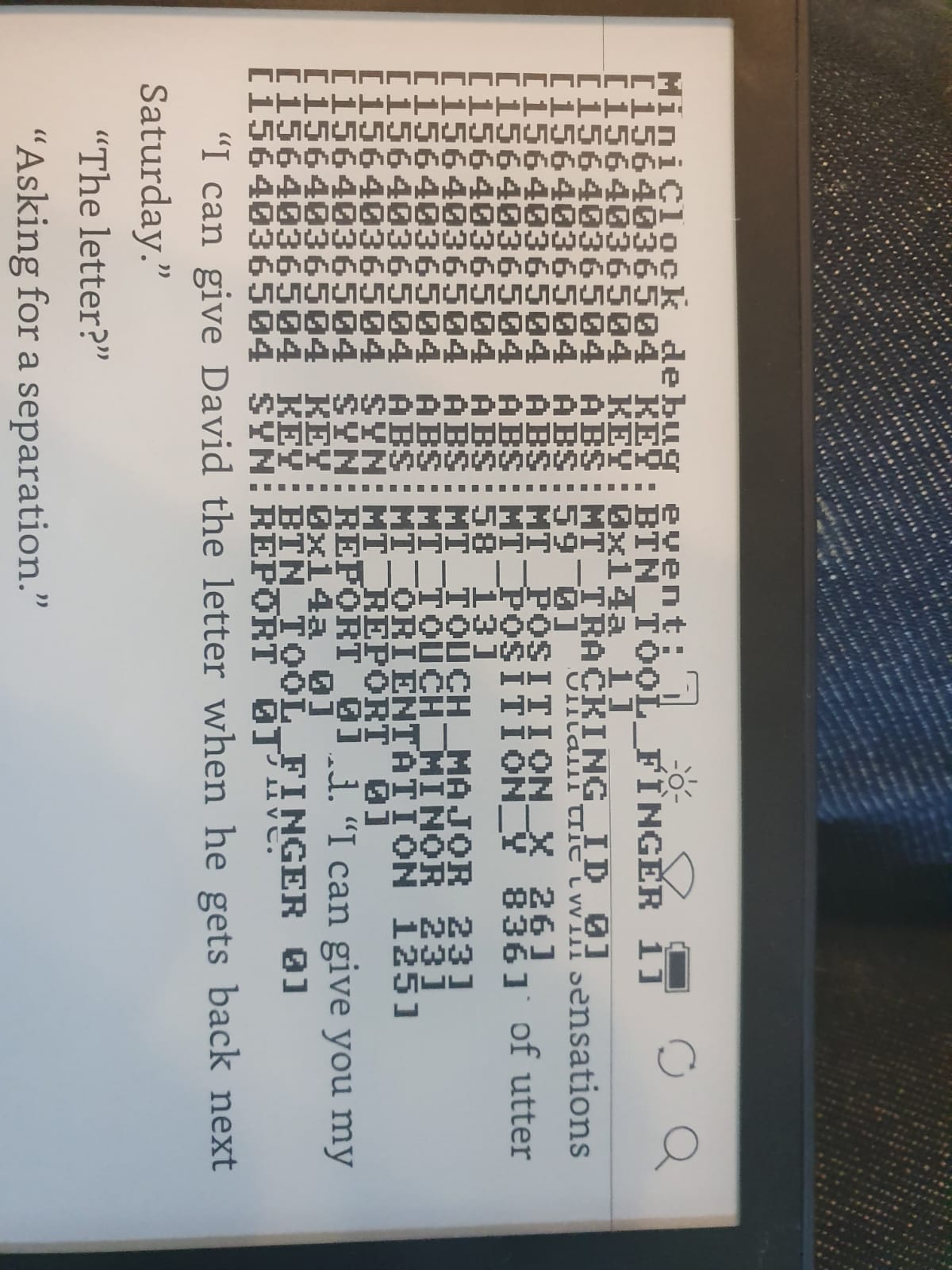

Ok have enabled debug and tested with about 20 to 30 pages - just cycling through pages. I think the time and date came up every 3rd page maybe?
How do i export the debug file? The debugging comes up live on the top left of the Forma too for some pages.

Ah yes sorry i probably simulated reading a little too quickly with clicking through! I did a riveting 2 minute video - see:
https://streamable.com/abzo7
And attached a photo of a long debug message that occurred at the end.
poczynek is offline   Reply With Quote

OK, those are button events (KEY:F23 KEY:F24 in your video) as well as touchscreen event (ABS:MT_POSITION_X/Y on your photo). As long as you have these in your whitelist that is all normal up to here...
The version below changes the on-screen debug display to a debuglog.txt file to be found in .addons/miniclock/debuglog.txt (logs only if debug=1 is set in config file)

-- whitelist match --
-- cfg_delay = '1 1 1' --
-- clock update Thu Jul 25 11:12:12 BST 2019 --
-- clock update Thu Jul 25 11:12:14 BST 2019 --
-- clock update Thu Jul 25 11:12:15 BST 2019 --
MiniClock debug event:
[1564049546 MSC:RAW 26]
[1564049546 SYN:REPORT 0]
[1564049546 MSC:RAW 28]
-- whitelist not matched - negative 1 --
[1564049549 MSC:RAW 23]
[1564049549 SYN:REPORT 0]
[1564049549 MSC:RAW 27]
-- whitelist not matched - negative 2 --
[1564049550 KEY:BTN_TOOL_FINGER 1]
[1564049550 KEY:BTN_TOUCH 1]
[1564049550 ABS:MT_TRACKING_ID 0]
[1564049550 ABS:MT_DISTANCE 0]
[1564049550 ABS:MT_POSITION_X 1311]
[1564049550 ABS:MT_POSITION_Y 797]
[1564049550 ABS:MT_PRESSURE 113]
[1564049550 ABS:MT_TOUCH_MAJOR 23]
[1564049550 ABS:MT_TOUCH_MINOR 23]
[1564049550 ABS:MT_ORIENTATION 124]
[1564049550 SYN:MT_REPORT 0]
[1564049550 SYN:REPORT 0]
-- clock update Thu Jul 25 11:12:32 BST 2019 --
-- clock update Thu Jul 25 11:12:33 BST 2019 --
A small observation, in case it helps. I had a feeling that when a next button failed, there was a brief sighting of an updated time/battery display AFTER the button press but BEFORE the page actually turned. But once the page turn had completed the display was blank.
ETA: I forgot to mention that there was no excessive battery drain overnight with the Forma on standby in a magnetic sleepcover. So definite progress on that front.

[1564048341 REP:DELAY 400]
[1564048341 REP:MAX 80]
[1564048341 MSC:RAW 24]
[1564048341 SYN:REPORT 0]
[1564048341 MSC:RAW 28]
These events are new to me (also REP:MAX should be REP:PERIOD... the woes of parsing input-event-codes.h in reverse :-) ). I don't see anything the like on my H2O. They didn't trigger cooldown for you in this instance but it came close (event occured 2 times in a row when 3 times by default triggers the cooldown).
-- clock update Thu Jul 25 10:54:36 BST 2019 --
-- clock update Thu Jul 25 10:54:37 BST 2019 --
-- clock update Thu Jul 25 10:56:11 BST 2019 --
There should be 1 second delay between these but it turned out as almost 2 minutes. Issue repeates at 10:59 and 11:06.
This is probably a case of nickel putting background process in the freezer.
EDIT: You could try and see if it improves by setting delay=1 or delay=2 onstead of 1 1 1. but delay=1 will miss update time if the pageturn (or other screen refresh action) is slower than 1 second. pageflips on H2O can be quite slow hence I used 1 1 1 but maybe Forma has faster pageflip so delay=1 will work. :EDIT
With the current code I guess it is possible to miss the first event after wakeup... as during those 2 minutes, the update was still in progress and no new events were listened to. Most likely the 10:56:11 update then happened straight on wakeup, to be erased by the pageflip that follows.
