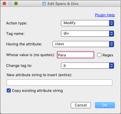

Yes - this was exactly what I was looking for. It looks a bit manual in that you need to do each html file separately, but it gets the job done.
I'm attaching the settings that worked for me in case someone runs into this same issue.
Thanks!

Try dragging or shift clicking and select several files; some of the plugins allow you to work on several files at the same time.
I don't have this plugin installed anymore, but I seem to remember that there was a sub-menu option to choose between whole book and current file only.
Old 07-21-2019, 11:06 PM   #12
Posts: 31,980
Karma: 65700000
Yep, it is on the icon as a setting
