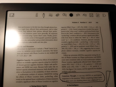

Can't locate scribble disable button
Hi,
Originally Posted by nozonyan View Post
just disabled the scribble mode. Once you open a book tap in the middle and look among the icons which will appear on the top bar. One of them disables scribble mode. After that you can use the pen as if it were a finger.
Sorry, I can't locate the icon to disable scribble mode: see images as attachments
The leftmost icon in the top right corner of "menu app" (left of the dictionary icon) did look like disabling scribble mode. However, it disables the pen altogether, not only scribbling.
Do you have an older SW version?
Problem is you won't be able to write. So, if you switch often between highlighting and writing it's quite a pain in the ass. I don't write, ever, so I just keep the scribble option permanently off.
Since I do highlighting all the time and very rarely scribble, this would be almost no issue to me.

Old 07-20-2019, 08:33 PM   #7
nozonyan
nozonyan began at the beginning.
Posts: 35
Join Date: Oct 2016
yes, that's the icon. Once you click it you should get a message "pen disabled" but it shouldn't actually disable any interaction with the pen, just the writing functionality. That's how it is on mine. Latest FW version.

Thumbs up Annotating works; manual would be nice
I played around a while to find out that this is also working on my device. However, I must not touch the display with the palm of my hand while trying to mark words: put down only the stylus tip, wait for two seconds and then I may start to mark words.
Not the UX I was expecting but with your help I could make it run.
