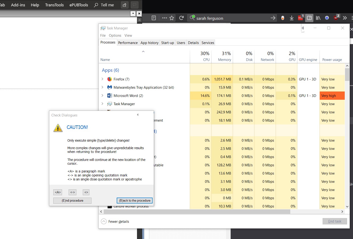

In the following screen shot you will see Word is using a lot of CPU and its Power usage is Very High - but it's waiting for me to correct a mismatched quote (") pair - which seems odd to me - it should not take that much grunt to wait for user interaction

Which is borne out by the S&R tool, I do not see anything like those values in task manager when this dialogue pops up

My gut feeling is that the 'inexplicable' high resource usage by DC has been ever thus. And one or more changes in recent updates to Windows and/or Word have exacerbated it - i.e. driven it over a cliff.

I can actually explain that usage. It has to do with how the breakout is handled. The procedure comes into a loop and checks if the 'return' button is pressed. The loop is causing the usage, as it needs to do something. In fact, if you breakout in the S&R, you should see the same, as the same code is used for that.

In S&R I only see high CPU and Power usage numbers when I use the "Pause and make small adjustments' button, they fall back to low levels when I hit the "Back to the Procedure button" and it goes back to searching.
In Dialogue Check I see those high usages throughout the entire process, when its scrolling (down and up) searching for mismatches, when it finds a mismatch, when I'm correcting the mismatches, right through to End of process popup. That would seem to imply its in the -- The procedure comes into a loop and checks if the 'return' button is pressed -- state all the time.
