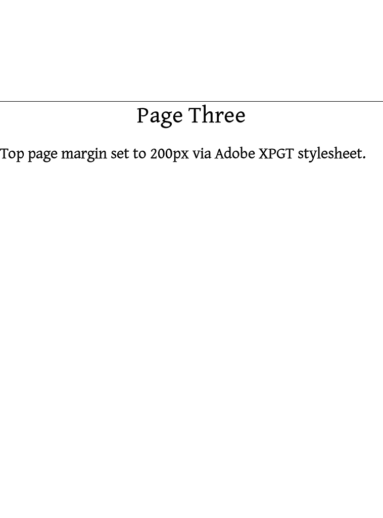

Do ePub page margins still work?
Can anyone confirm whether the `ePub fixed/adjustable top/bottom margins` patch still works? One report that it doesn't.
If the patch isn't working, could someone who doesn't have either of the `ePub fixed top/bottom margins` or `ePub fixed/adjustable top/bottom margins` patches enabled check whether ePub page margins are still working in this firmware version?
You can check on a device without the above patches enabled by sideloading the attached ePub book. If page margins are working properly working then there should be a large top margin on pages two and three, as in the screenshots (from my Glo running 4.8.11073):

Old 07-21-2019, 09:19 AM   #85
npr
npr can name that ebook in five wordsnpr can name that ebook in five wordsnpr can name that ebook in five wordsnpr can name that ebook in five wordsnpr can name that ebook in five wordsnpr can name that ebook in five wordsnpr can name that ebook in five wordsnpr can name that ebook in five wordsnpr can name that ebook in five wordsnpr can name that ebook in five wordsnpr can name that ebook in five words
Posts: 120
Karma: 37418
Join Date: Jan 2013
Device: H2OE2, Libra 2
I've tested your file "PageMarginTest.epub" on my Kobo H2OE2 and it displays as show in your above post.
ie Page 1 no top margin.
Page 2 and 3 greater top margin which I would estimate at 200px.
Firmware: 4.15.12920

Old 07-21-2019, 09:40 AM   #86
GeoffR
GeoffR's Avatar
Posts: 3,821
Karma: 19162882
Join Date: Nov 2012
Location: Te Riu-a-Māui
Device: Kobo Glo
Thanks, that is good to know. So if the `ePub fixed/adjustable top/bottom margins` patch is not working then it must be something I have done wrong in updating it.
