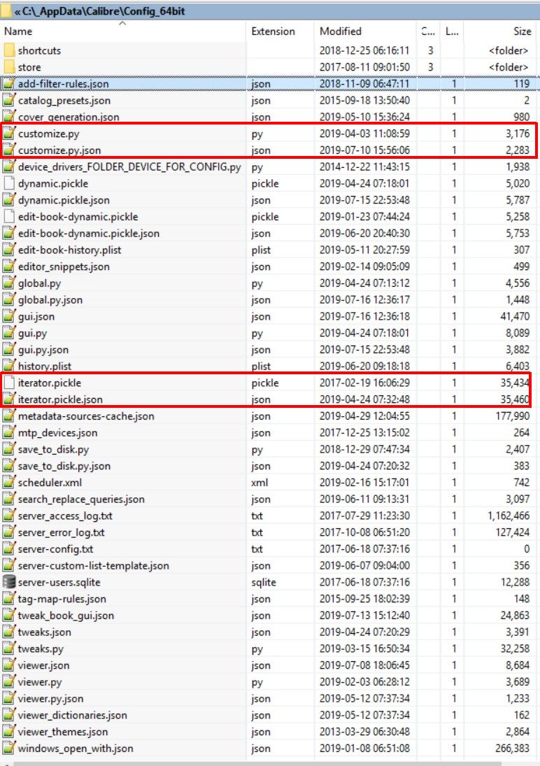

I notice I have several pairs of [xxxxx.py + xxxxx.py.json], and [yyyyy.pickle + yyyyy.pickle.json].

Should I have both?

yes havong both files is normal, if it bothers you, you can delete the .py ones.

Firstly I don't have any issues with missing plugins or email addresses (I don't user that calibre feature).
I upgraded from 3.41->3.41.1->3.41.2->3.41.3->3.42->3.43->3.44->3.45->3.45.1->3.45.2->. The releases I skipped are struck out and grey.
Attachment 172417
Should I have both?
As Kovid said, it is normal and you can delete the .py files now. But...
Kovid changed the way these preferences were stored in 3.41. This converted the .py files to .py.json. Once that was done, the conversion isn't done again and the .py files are ignored. All the versions up to and including 3.44 did this correctly. That means if you installed any version in the 3.41 to 3.44 range of version, everything is OK. But, if you skipped directly to 3.45.x, the conversion of the .py files to .py.json could be wrong and the options will probably be reset to the defaults. It depends on exactly what was in the .py files. The driver configurations will all be affected. I don't know about the other files.
Thanks - FYI I am left with
device_drivers_FOLDER_DEVICE_FOR_CONFIG.py
tweaks.py
There is no .py.json for those two.
