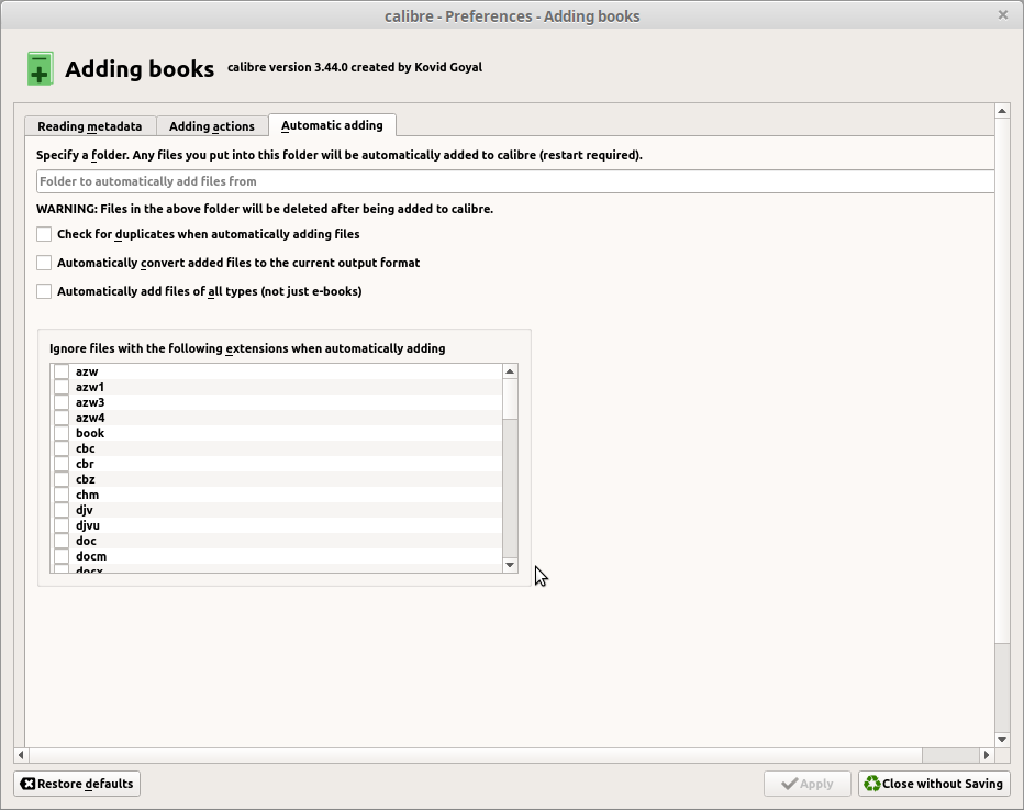

My best suggestion is to use a a VNC, open the GUI on the calibre server then preferences-add books-automatic adding.
bernie
Name:	Screenshot from 2019-06-17 11-36-16.png
bernie
I'm not sure how easy that would be with the way I have the security set on my server, but I will take a look at it.
