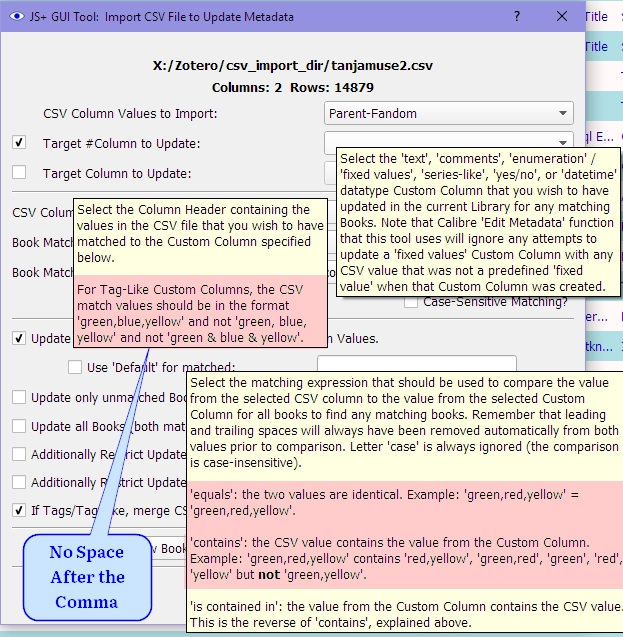

CSV Column for Tags & Tag-Like Custom Column Matching
See the attached image that explains the problem you are having.
Do a search and replace on that column of your CSV to eliminate the extra space after the Tag separator ','.
DaltonST

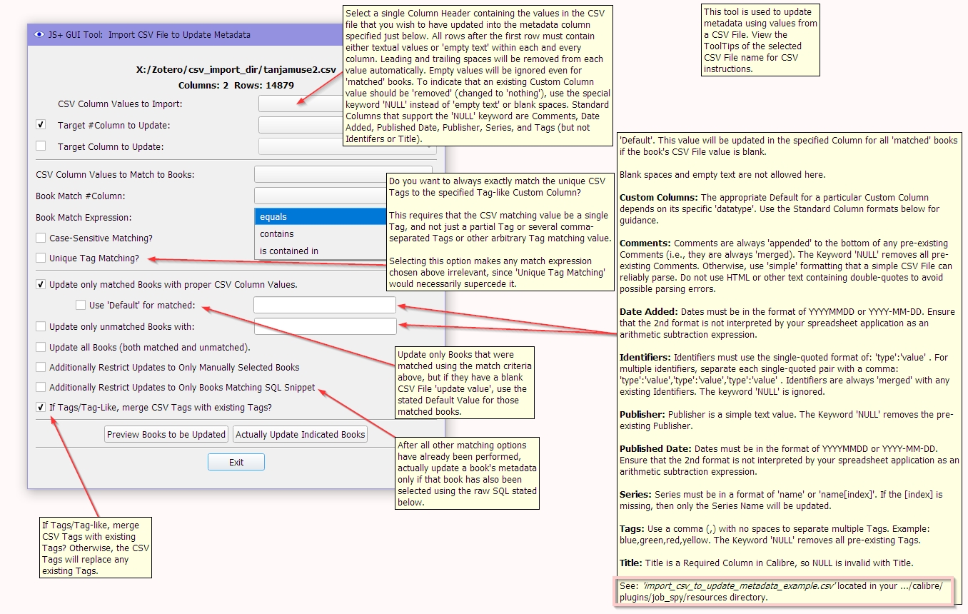

Version 1.0.156 - 2019-05-13 Python 3 compatibility; Calibre Version 3.41.3+ compatibility; Miscellaneous technical changes; Enhancements to "Import CSV File to Update Metadata" tool; Customize TagBrowser Icons tool fixed for @UserCategory-subcategories.
See the attached image for the latest "Import CSV File to Update Metadata" tool.
As always, read the ToolTips by hovering your mouse over every area of the tool.
DaltonST
