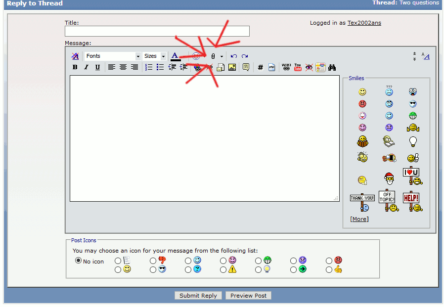

Note: In the future, attach images using MobileRead's built-in attachments. When you post, the icon looks like a little paper clip. This makes it so appear within posts fine, and makes sure they don't break the layout:
Attachment 171572
Also has the advantage of not disappearing if those external image sites die. So many older topics have busted images, and the information gets lost.
