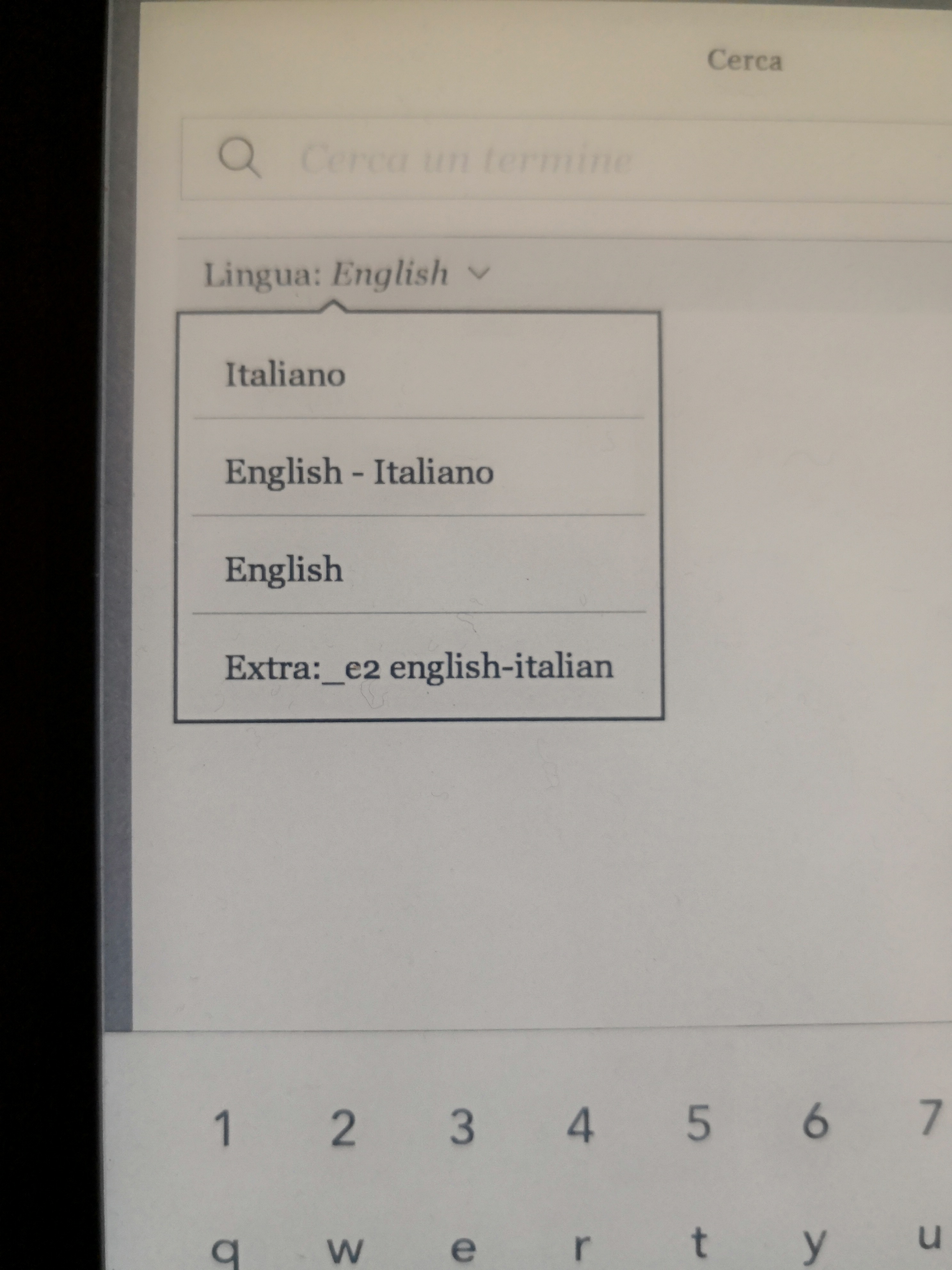

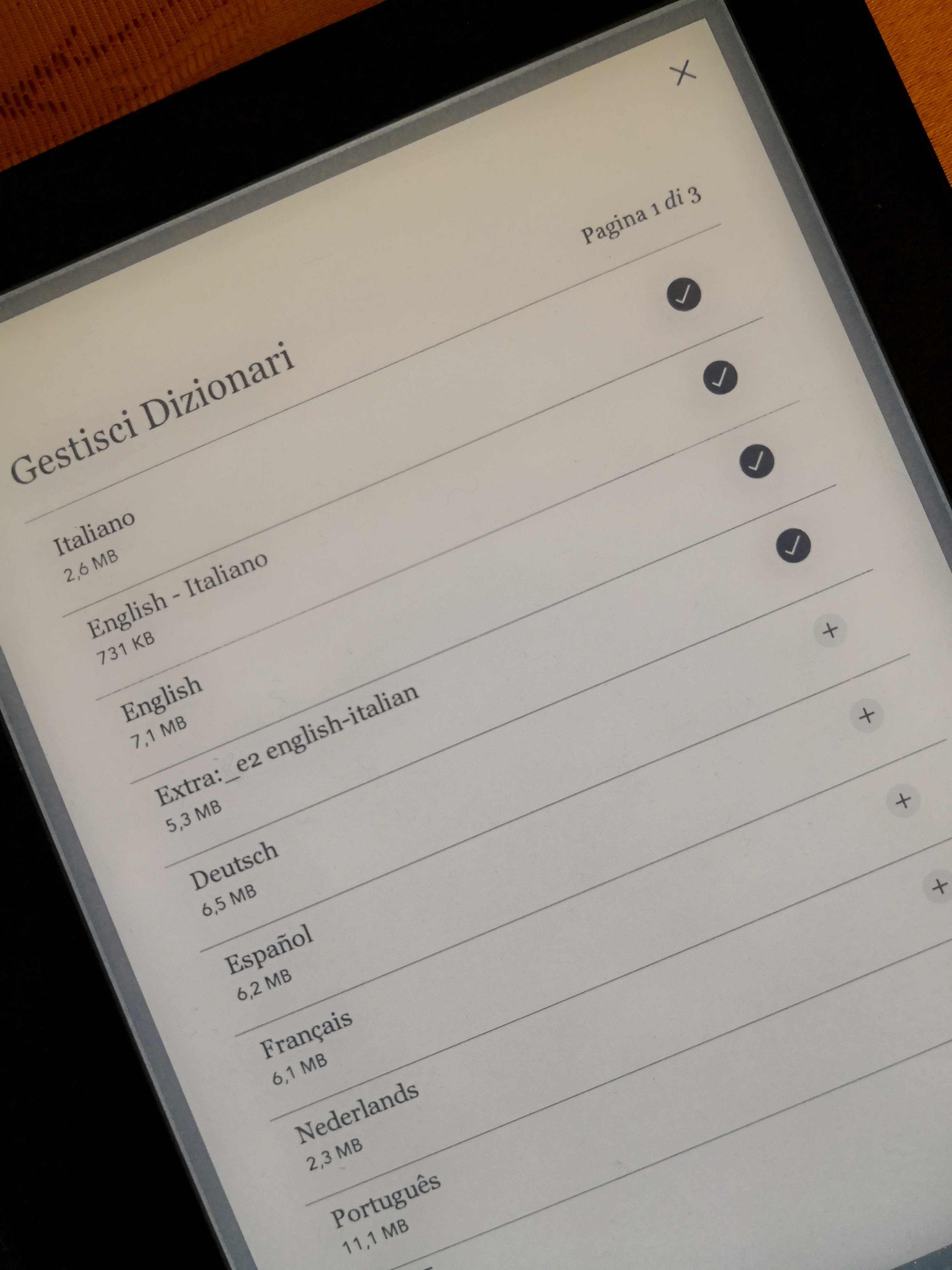

Didn't work when i try to click on my custom dictionary, the kobo switch strangely to the english dictionary, as the Extra:_xx didn't exist. The screenshot is when i copied only e2, the english dictionary i would like to add on kobo. Is it sure i didn't any mistakes on the first step?
I read something about to change the last rows for the new firmware:
find_base_address = `\0Extra:\x20`
replace_string = 0007, `\x20`, `_`
</Patch>
are these the right ones for 4.8.11073 firmware? Thanks you very much to everyone.
Are you sure you've copy dicthtml-e2.zip file into .kobo/dict folder?
Good luck.
