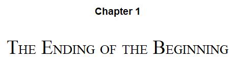

display: block actually has quite a useful purpose if used correctly. Be careful when you say things like that...maybe clarify with: "When using two different block level tags, display:block is redundant."
My example uses 'display: block' correctly in a minimalist fashion and achieves the OP's request quite well (it is even in pretty CSS just for you!):
<h3>Chapter 1 <span>The Ending of the Beginning</span></h3>
/* (however you want to style it:) */
h3 {
	font-size: .75em;
	margin: 2em 0;
	text-align: center;
	font-weight: bold;
        font-family: sans-serif
h3 span {
	display: block;
        font-size: 2em;
        margin-top: 1em;
        font-weight: normal;
        font-family: serif;
        font-variant: small-caps
Of course there are multiple ways to achieve the results and mine is just one example.
