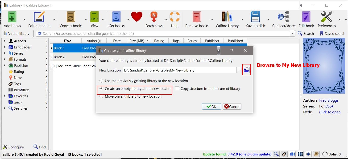

Old 05-16-2019, 06:46 AM   #13
Posts: 22,871
Karma: 34252730
Create a new folder in Calibre Portable (where calibre-portable.exe is), viz:
In calibre, select Create/switch library and set up a new library in the empty folder, viz:
Tick the "Copy structure..." box if needed
Copy structure from the current library
Copy the custom columns, saved searches, column widths, plugboards,
user categories, and other information from the old to the new library
