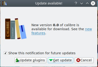

I got this when I started the beta (calibre-3.40.3-x86_64):
PandathePanda is offline   Reply With Quote

@PandaThePanda, that's weird but I will add some code to ensure it does not happen. Can you run calibre in debug mode and post the log, that popup indicates that downloading the latest version is failing for you, I'd like to know why.
