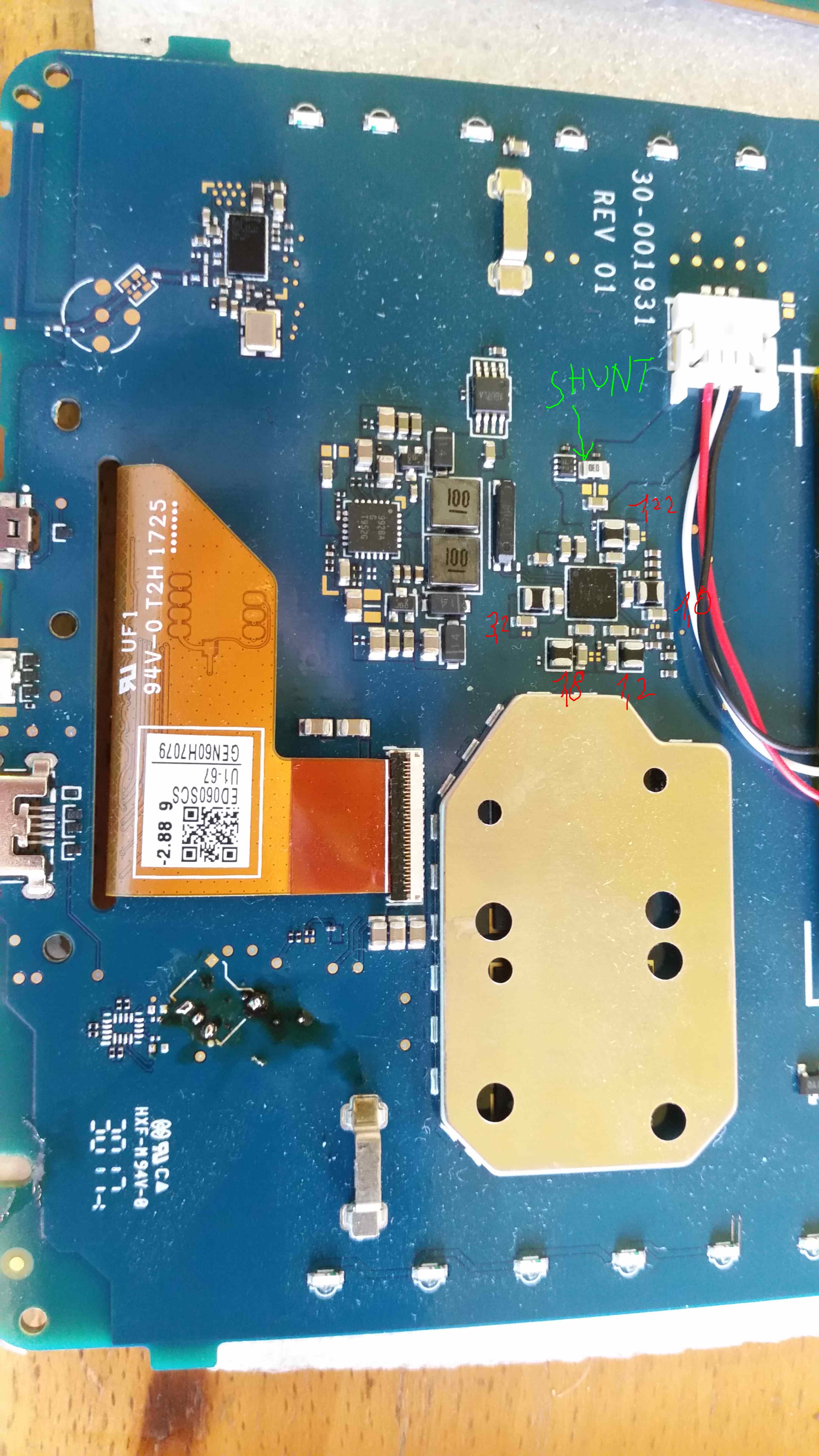

I suggest to look around Rohm PMIC BD71815AGW because I have experience with simmilar errors in log and behaviour. Let me explain. I found also KT3s with fast battery drain. Depleted in 2 hours. So I opened it and found out with voltmetr that battery is still almost fully charged (4.09V).
After battery reconnection I booted device again to saw that now it shows 85% and the percentage of battery went down as fast as before.
Kindle only „thinks“ that voltage goes down.So why fake draining?
Connecting to serial line I saw in protocol some coulomb counter errors(and also those mentioned by dom123dom - DEBUG:keypad.c:105:keypad…..) . I booted to bist and tried folowing:
bist > vni batt vol
FG voltage =4044mV
bist > vni batt temp
FG Temperature = 31C
bist > vni batt curr
FG Current = -1351mA
bist > vni batt cap
FG Capacity = 85 Percent
Voltage mesuring and capacity was ok but the current consumption was not real. In datasheet for BD71815AGW I found Coulomb counter block and current sensing 30mOhm resistor (shunt).
After replacement of shunt is everything allright. After 2 months there is no fake draining and no more DEBUG:keypad.c….. errors.

In last 2 months I have replaced successfuly another 4 shunt resistors. I wanted to wait some time to confirm that this repair is reliable and post it here. Hopefully it can help to someone. I am not offering any paid services. My apologies for english errors or rule violations if I commited some.

Looking at the datasheet here: https://www.rohm.com/datasheet/BD71815AGW
I can see what you mean it talks about:
Embedded Coulomb Counter for Battery Fuel
Gauging
- 15-bit ΔΣ-ADC with External Current Sense
Resistor (10 mΩ, ±1% or 30mΩ, ±1%)
- 1-sec cycle, 28-bit accumulation
- Coulomb count while charging/discharging
and
15-bit ΔΣ-ADC measures the battery’s charge and discharge current by means of an external current sense resistor
(10mΩ, ±1% or 30mΩ, ±1%).
So should it be 10mΩ or 30mΩ for the Kindle? You mentioned 30 above.
Is this the right one?
https://www.digikey.com.au/product-d...RCT-ND/2003876
EDIT:
With a magnifying glass I can see 030 printed on the chip so I just bought the ones below, I hope they are the right model!
MCS1632R030FER - Ohmite - Current Sense Resistor
I think this will be very challenging soldering for me, it looks tiny.

Sorry for late reply. It is definitely 30mΩ. I´ve never tried 10mΩ but it should work as well.
Meanwhile I was playing around with another piece with same issue. I tried only to reheat the resistor and it has been working for 13 days till now.
I think about 2 possibilities. 1)Change of the resistivity to right value because of the heat(hardly possible but I´m not an expert). 2)"Reset or recalibration" of values in BD71815AGW after soldering. There is significant time gap (5-10min) after soldering. Heat protection I guess. Could be the heat a side effect of values reset in IC?

I tried to warm up 030 resistor to remove it, I'm finding it extremely difficult, tried tweezers, tried a small screwdriver to pry off, tried my soldering iron. In the end I set my heat gun to 250 and tried to heat up the solder a lot. Still not really working.
So anyway I warmed it all up and thought i may as well try charger and see what happens.
I still get the same boot, it stops at the same point...the output tells me 46 degrees.....but now I have an orange charge light!
@Bembela What method did you use to remove the shunt?

Soldering iron station. It consumes a lot of heat especialy one side of resistor. I tried also heat gun but after that there were black stain on the display. Eink is sensitive to heat. So be careful. I`m using notebook cooling pad to avoid screen damage.
So where are you now?Can you post log?
