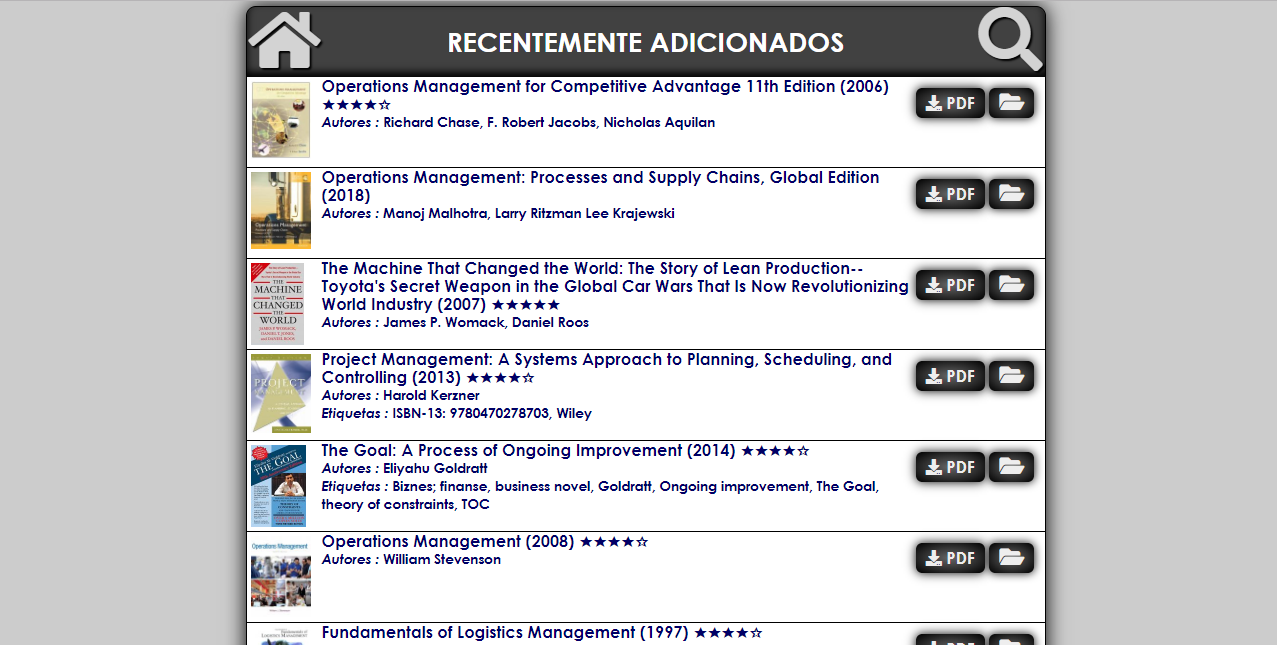

i have installed this through container on qnap
https://hub.docker.com/r/linuxserver/cops/tags
no commands needed
installed the 1.1.2ls9 (i think it is latest version) because my nas is x86 processor
created a folder named COPS on my container folder (its created by container station when installed)
on advanced settings: network i left it has NAT changed host port to 54321 and container port 80
on host shared folders i shared my cops folder and entered \config
and shared my calibre library folder and entered \books.
and i think it is up an running when i put on my browser localhostip:54321

I just can´t use it on my tablet on all apps... well i can access and setup an online library, but i cant add the books to the app bookshelf and i would like that.
I suppose it has something to do with html settings on the apps like moon reader but i cant seem to figure that out.
because i just want to read it via streaming.
can someone give me some hints on this, i would like to access my library on my android tablet.
(dont know how to put image smaller)
