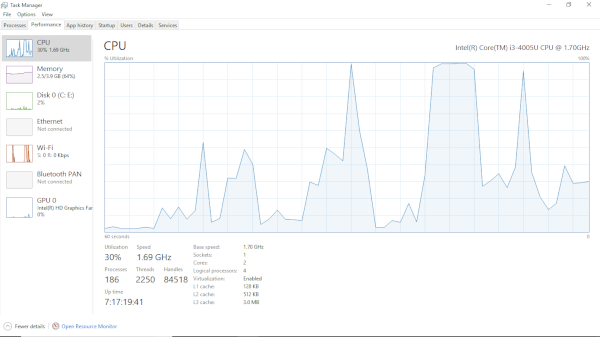

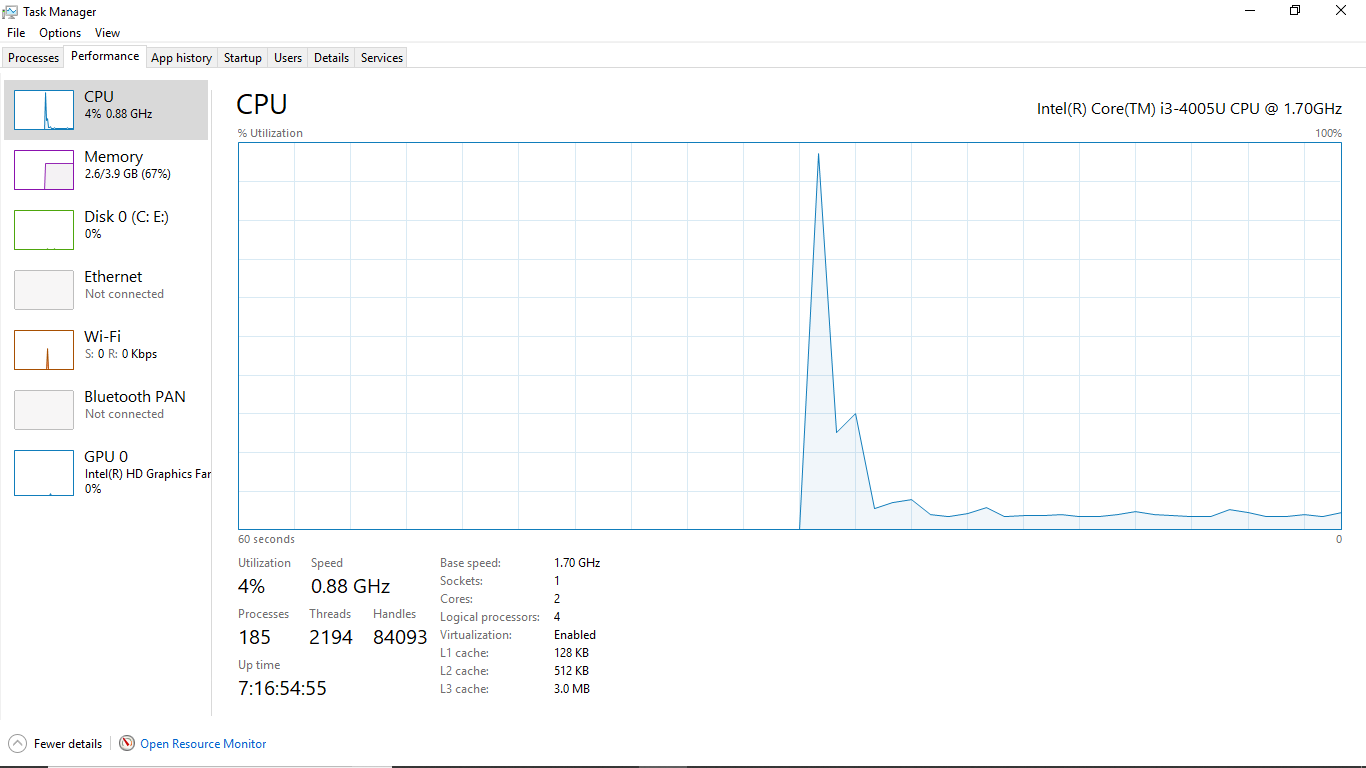

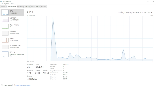

Okay here is what I have done.
I uninstalled Sigil 9.10 after backing up my INI files.
I deleted the C:\Users\Brent\AppData\Local\sigil-ebook folder.
I shut down my laptop completely.
I restarted my system.
I installed Sigil 9.13.
I opened the Gutenburg file I have saved local. I despise cloud anything.
I started renaming, splitting at cursor, and even cut and pasted some text and two images.
I then checked my medical balance using Google Chrome, and even paid the bill.
I closed Google Chrome and Sigil was open behind.
I deleted an empty HTML file.
When I save the file I got a quick not responding. (See Memory.png)
I the checked what files were in the startup tab (See Startup)
I decided the run a report on the Sigil file and received reports not responding (See Reports not responding)
Look at memory (See reports)
reports did eventually appear.
Will continue modifying file.

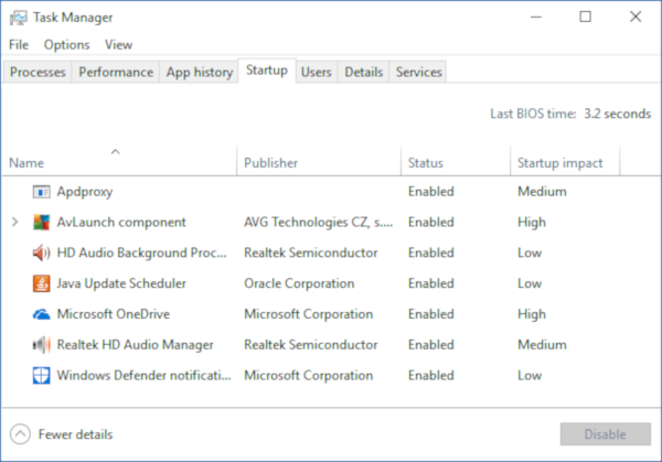

AvLauncher is part of Avast free anti virus and should not be running if you are using Windows Defender. I think Apdproxy is some sort of background program to upload images as part of Adobe software and should probably be disabled.
In fact anything non-microsoft should be temporarily disabled (and reboot into safe mode) and then try again with Sigil just in case something here is messing with it.
Will look at the Apdproxy because I removed Adobe reader as it was keeping Chrome from loading. would have to go into task manage and end task all the time.
