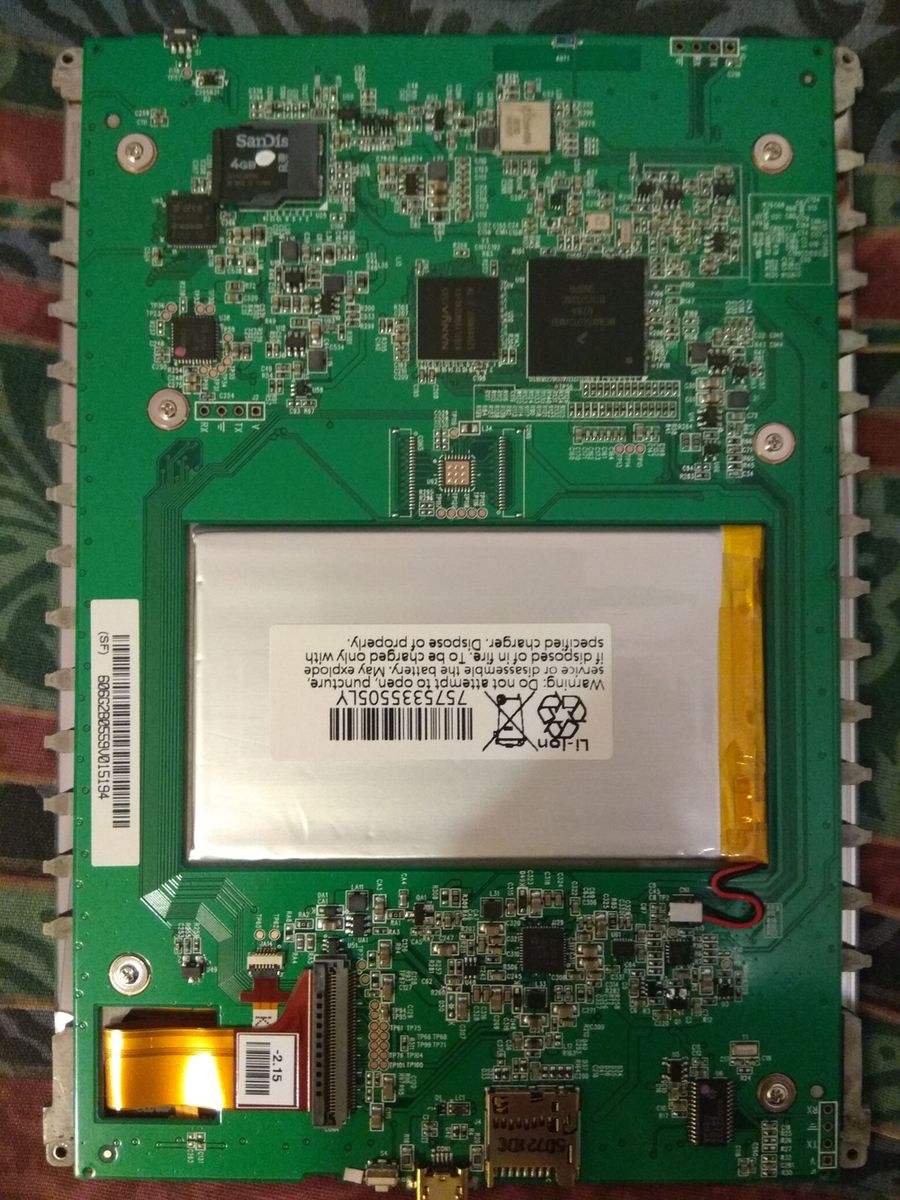

Well... I've gone and done it: I've opened the beast.
And I think I screwed up.
I tried to be as gentle as possible!, I did! But it seems the bottom of the display bent a little, and the screen now shows an oval pressure point on the bottom...
When turning the device on has the screen completely frozen, though the lights are working still. Even if the screen is responsive, I wouldn't be able to know.
I don't know if I've completely wrecked my child, but if not: where can I see the product ID?
I'm sharing pictures so everyone can see how it's looking.
Thank you for the help!
Well, it's pretty normal esp. if the screen was already broken to begin with. That's the one downside of this eInk technology, the screens are just wayyy too fragile. And if there are already cracks in it the rest of it is just even more likely to shatter too.
Sidenote: is that a carpet in your picture? Electronics hate carpets and the like ( https://en.wikipedia.org/wiki/Electrostatic_discharge ) so you might want to use a different surface here (wooden table or plain oldfashioned newspaper also works, or if you build your own PCs you'd probably find an ESD bag in your mainboard box or sth.).
On your pictures in the lower left, there are these two flat cables ... they are the display cables. The connectors they are stuck in have these levers or latches on top, you have to lift the latch (carefully not to break em off) then remove the cables and ... the product id should then be printed on the other side of the cable that is currently not visible.
You might have to take the mainboard off entirely to be able to remove the old screen, but I'd only do that once you have the replacement screen at hand (so you know the exact placement and such)

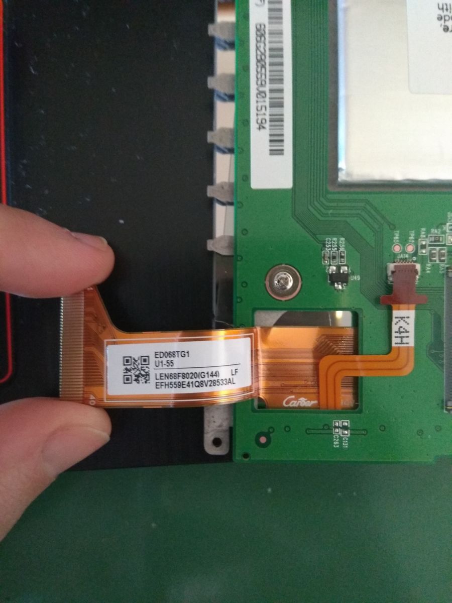

Frostschutz, you are the best!
I was able to open both connectors, and I got the serial number! Picture attached.
The model seems to be ED068TG1(LF), which, funny enough, is the same model I posted previously, ahahahah
Though, correct me if I'm wrong!
Thanks again for all the help!
still it's good to confirm these things beforehand
higher chance of ordering the correct part and actually being able to apply it once it arrives
so don't do anything until then
careful when taking the old display off, you have to deal with glass shards and what not
the challenge then will be ... putting the new display in ... correctly and perfectly aligned ... without breaking it ... super fragile
good luck
ReaLx3m, I would do what you request of me (try how hard is it to take off the light strip that is glued to the screen and try sticking them back on), but won't that lower my changes of reviving my machine? Or is this only dependent on the display (which is going to be replaced?)
Well we shure wouldnt like that .
By looking at the pictures with the replacement screens on ali im under impression that they come with the light strip on them and you would dispose of the old one together with the screen.
The part in red is the light strip.
But i havent changed any ereader screens(so far only done a sd card replacement), so anyone with more experience correct me if im wrong.
