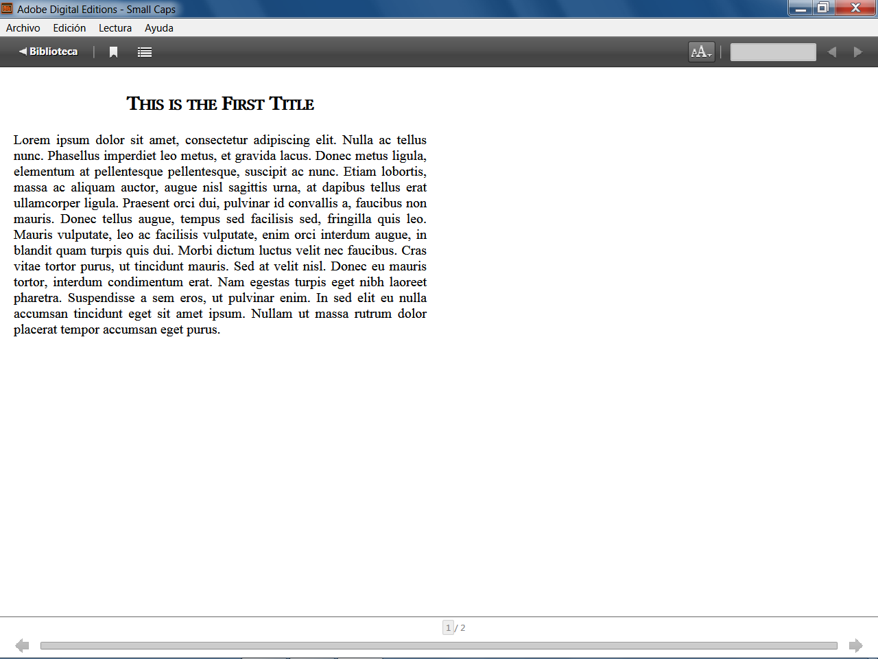

Well, there must be something that you are doing wrong:
By the way, the font you uploaded is not a small-cap font but a regular one.
Below you can check the respective epub with small-caps and the font you want to use.
Regards
For the last years, I used a dedicated small-cap font and still do. Today's problem is different and there is a misundertanding I'd like to clear. Yes, this font is a regular one but it has optional smcp capabillities
Please, do analyze my font using this site
Select the "features" tab. You'll see that it has indeed some optional features which are "off by default". Among them, using small-caps.(see screenshot).
My question is how to use them on an ePub?
I am afraid that using font-variant: small-caps does not yield good results. Your ePub does not display smcp characters coming from the font using Sigil ou Calibre.
There is a simple way to check if you really use smcp characters coming from the font. Try to write: &. You should get the second character on the left of the screenshot.. (I've put a circle around it)

Hi Roger,
So, you are not seeking small-caps but how to enable some features on .otf (by the way, the font you uploaded is a .ttf, or not?). It's not possible for now to get what you want, at least, on epub. Nor property "font-variant-caps" nor property "font-feature-settings" will work, except "font-variant-caps: small-caps" (and with any font, not only with .otf with special features embbeded). Give a look to this pages:
