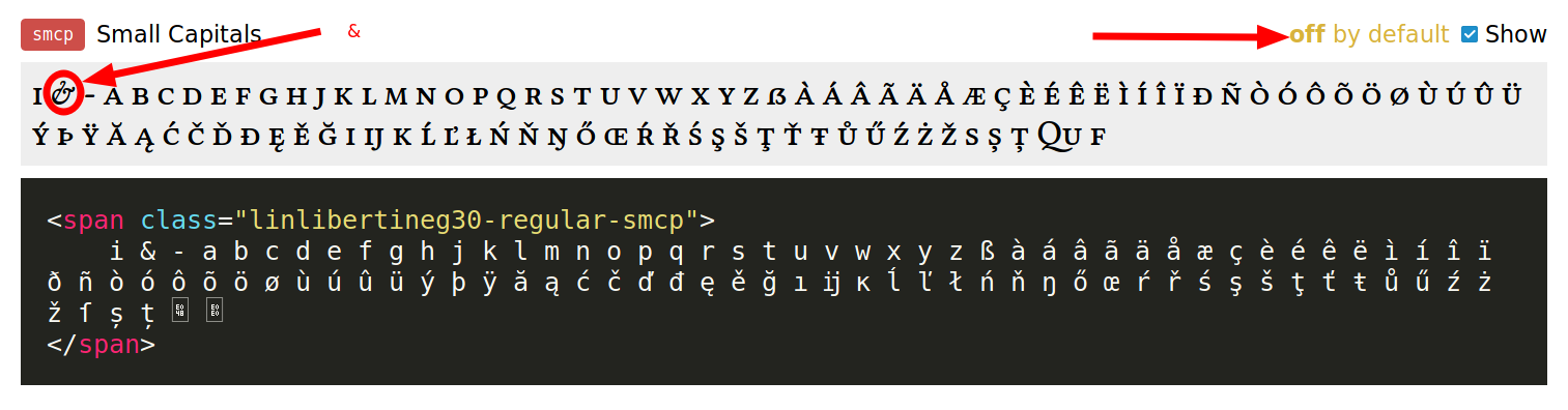

Please, do analyze my font using this site
Select the "features" tab. You'll see that it has indeed some optional features which are "off by default". Among them, using small-caps.(see screenshot).
My question is how to use them on an ePub?
I am afraid that using font-variant: small-caps does not yield good results. Your ePub does not display smcp characters coming from the font using Sigil ou Calibre.
There is a simple way to check if you really use smcp characters coming from the font. Try to write: &. You should get the second character on the left of the screenshot.. (I've put a circle around it)
I add a second screenshot, showing a PDF exported from LibreOffice, using characters from this font, and which displays small-caps correctly, and also (see red marks)
- standard ligatures (on by default)
- old style numerics (off by default)
This is the result I am aiming for.
