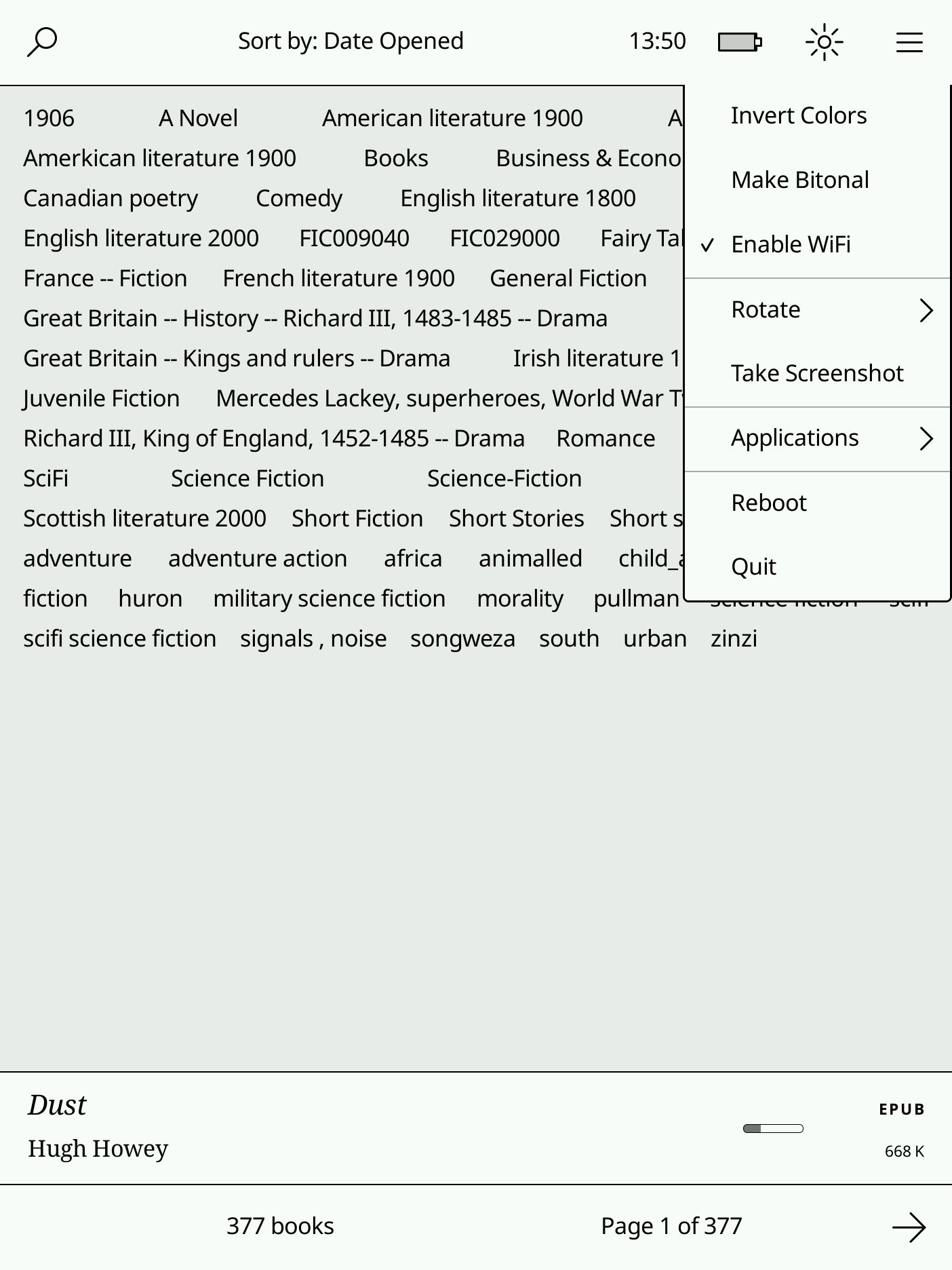

Originally Posted by pst View Post
I find the folder navigation bar a bit confusing. When I'm at top level, it seems to show all the folders now, sorted by name. I can't really navigate trough my collection this way, it gives no hint of the actual folder structure.
Please have a look at the screenshot - "Book" is actually the root folder, that is currently selected.
What the summary bar shows are the categories. And no, as mentioned before, the hierarchy isn't flattened: you're getting confused by the dc:subject tags.
One thing you might want to do is to increase the default height of the summary bar:
[home]
summary-size = 2
And I should probably add a setting to prevent the dc:subject tags from being imported as categories…
baskerville is offline   Reply With Quote
Definitely. I should have noticed from my own screenshots, "American literature 1900" is not the folder "American literature".
[home]
summary-size = 2
Nice, for sure I had to try setting it to 10, which got me a nice overview of all the categories:
That would be nice. Thanks for your great work.
