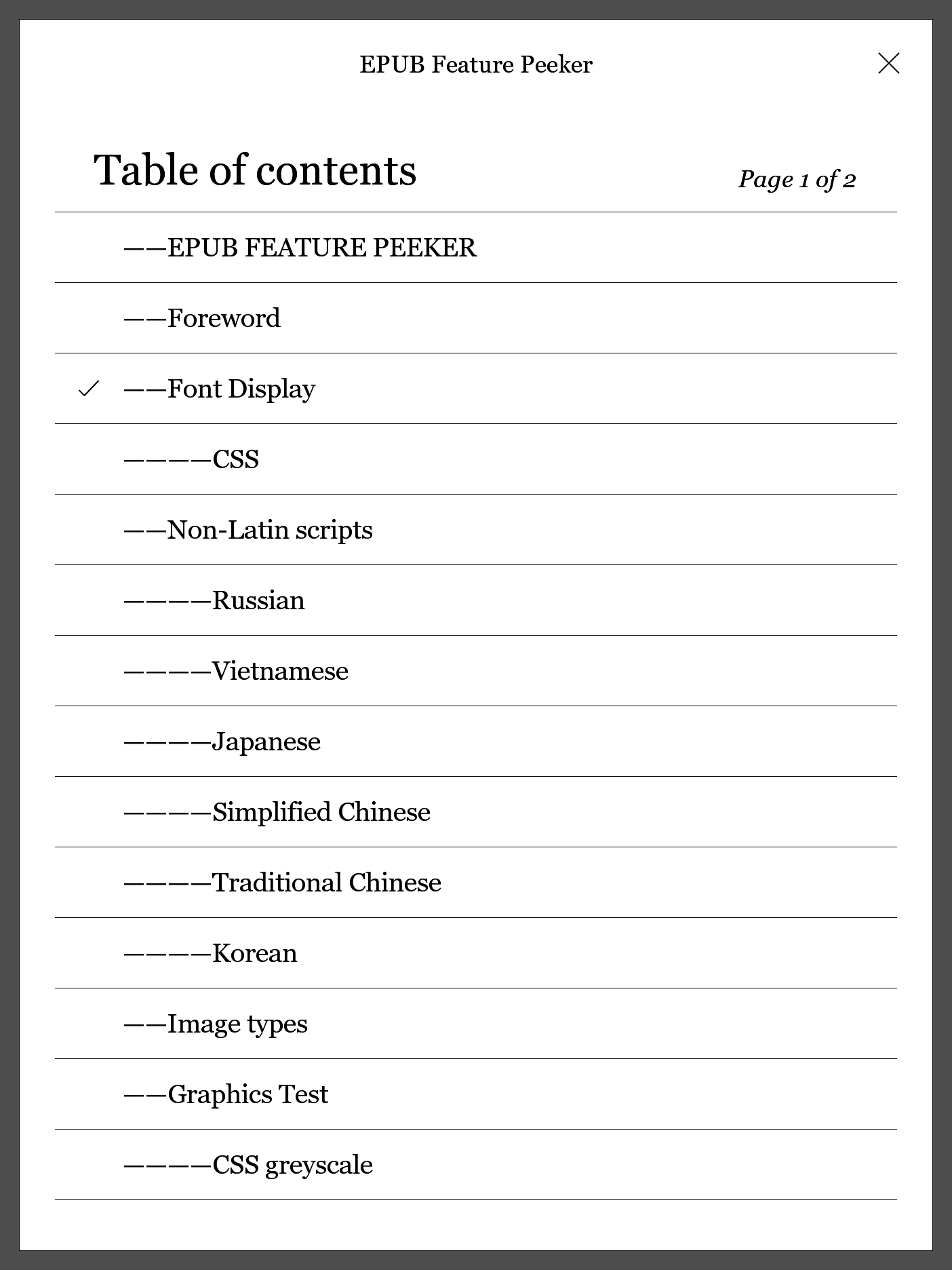

Originally Posted by ps67 View Post
Is it possible a patch to have indentation levels in index? I know that Kobo index is flatten by design and I don't know if that behavior can be changed with a patch, but if:
1) it is not too difficult (like hours of work);
2) it is funny for You to do the patch;
3) You have time to do it;
I would like to see how could appear a patched index.
Firstly, by "index", I assume you mean the "Table of Contents".
There are going to be two problems with doing this. One is changing the layout of the screen to show the ToC levels. The other is to get the levels. The latter is what I know about.
The ToC is built from the database. The database is populated when importing the books for sideloading, or when the books are downloaded from the Kobo server. There is a column in the database that appears to be for the ToC levels (content.Depth), but it is not populated for sideloaded books (always zero). It appears to be set for purchased books. Populating the column for sideloaded books wouldn't be that hard. But, whether this is read and put somewhere that can be used when building the ToC screen, I don't know.
Rather than trying to wrangle the Kobo firmware it might be easier to add it as an extra option in KoboTouch to be called during send-to-device. A bit like 'Modify CSS', but this would be 'Modify TOC'.
I think calibre's TOC functions could be used to add some kind of pseudo-indentation padding as a prefix to each TOC entry's text.
This would only work for sideloaded epub/kepub, of course. Not necessarily the most elegant solution, but it might suffice.
Ugly, but it would work. And the attached screenshot is a quick edit of the database to prefix the ToC entries with two em-dashes for each level. I tried spaces, but they don't show up. Non-breaking spaces probably will, but I can't be bothered to work out how to enter them.
And the space problem makes me wonder if the levels are implemented but spaces are used. I hope not. It's the sort of thing I'd do during development but hopefully it would have been noticed before now.
Also, when doing this, I discovered that the device I looked at before had no sideloaded kepubs on it. The above screenshot was for a sideloaded kepub and the Depth column was populated.
I'll have to think about this for the driver. I might do a quick-and-dirty addition to the Kobo Utilities to do this for books that have the depth column set. That would give a quick way for people to see it and give an opinion on whether it is a good idea. I also have to rewrite my ToC updater so it can be released. That would be another place to do something like this.
I don't think nbsps will work, as QString::simplified removes all chars which return true for QChar::isSpace, which includes https://www.compart.com/en/unicode/category/Zs. I could write a patch to prevent this though (it's in N3TableOfContentsWidget::setContent(Shortcover const&)), and I might add the ability to use spaces for TOC depth feature to seriesmeta. Also, if this method is used, the chapter titles should probably be normalized too (simplified also removes repeated whitespaces within the string).
That's unfortunate. I suppose stripping leading and trailing spaces makes sense for something like this and that's simple way to do this and remove anything else that might be bad. I'll try it just in case. Or maybe there is something else suitable.
