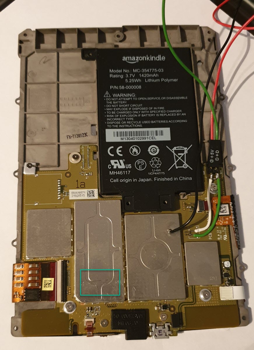

Here's a photo of the board with the location of the eMMC under a green box and another one with the heat shield removed.
It was very difficult to remove the heat shield, I had to brute force it with snips and pliers. You can see I damaged the board getting it off but it still boots.

I was able to remove the shields from my PW2 with a heat gun and some tweezers. The shields soaked up the heat nicely and quickly desoldered from the rest of the board. Just be careful not to bump any components while the board is hot or you could displace components and ruin everything.
Also the chip you labeled eMMC is the SoC. I think the eMMC is a SanDisk chip, not a Freescale chip

I was expecting a Sandisk chip but there's isn't one under any of the shields so I thought probably this one.....I'll post a photo of the board so all the chips are visible.
