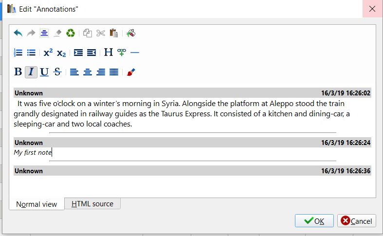

HI - I finally figured out how to use this plug-in!
(1) I only realised that halfway through your help instructions (at the beginning of this htread) you mention 'clippings.txt' but it was not clear that this plug-in totally relies on it. I had to read through several times before the penny dropped.
I had deleted my clippings file recently (it was getting large) and it took a while to figure out that the plugin wasn't finding my annotations because the clippings file did not match the books in my library!
Maybe a clear statement at the beginning that this plugin uses the clippings.txt file so do not delete it until you have copied the annotations in to Calibre?
It's not obvious to dummies like me!
(2) The annotations list appears in a window of its own - very useful but it cannot be resized! Could this be fixed? (I can drag column widths but this does not change the overall window width.)
(3) Similar point: could the annotations window remain open until it's closed by the user? If I select one book to import the window is automatically closed so I must reload all the annotations to select another book.
(4) My annotations show 'Unknown' instead of the book title. It is not clear how to change that. Also, it would be useful to make explicit the labels 'Highlight', 'Note' and 'Bookmark' as well as the location. These are in the clippings file but not added to the annotations although this is important information. Can this be done? (e.g. add further regex options).
[Note: this may already be possible but I can't see how to do it]
(5) A luxury item: it would be handy to have a 'save to text file' function on the annotations window (I realise that it has copy so that I can paste highlights into an application - but sometimes I need to do several at one sitting it would be just easier). However, this is a luxury item so not essential (unlike 2 - 4 above).
Overall this is a really useful plugin for a reader who keeps a lot of annotations and notes.
Thanks

There is a section labelled "Typical Kindle workflow". That states the details are coming from the "My Clippings.txt" file. I'm not immediately sure how to make it clearer.
The "Import annotations" window is sizable here. As are all the other windows in the plugin. You should be able to grab the edges of the windows and drag them.
I have no idea why you would want to do this. The annotations list window should show the books it found annotations in. Select each with a check-box, and press the "Import annotations" button. The annotations will be applied to all the books listed. Depending on how well the book and title in the clippings file matches the books in the library, you might get prompted to confirm the book is correct.
The book you select before starting is only used if matches can't be find. The annotations that aren't otherwise matched can be added to this book.
Where do you see this? I the "Import annotations" window? If so, I can't think of how it happens unless there is a problem in your library and this is the title of a book.
Or is it in the annotations? "Unknown" is used here if the plugin cannot determine the location of the annotation. It should be a page number or Kindle location, but if there is a problem getting these from the clippings file, "Unknown" will be used. If that is the case, there might be a problem with the file.
The plugin uses different styles for each. You can set this in the configuration.
I'll consider putting a "Copy to clipboard" option for the selected books in the list. But, the question then becomes exactly what to copy and the format to use. But, I don't know when I will do this.

On point (1) It might be clearer to users like me (for whom the Kindle is a bit of black box) to state at the beginning of the guidance that the plugin uses the clippings.txt file. So, if that file is incomplete (or worse entirely missing if the Kindle has been reset) then the plugin has no data to work on.
In spite of a mention in the 'workflow' section, it took a few tries to work out why I wasn't getting all my annotations because, as I said, I had deleted an earlier clippings file and started a new one. Anyway, the point is a bit moot I guess because now that I know it's become obvious but it wasn't obvious to begin with (and others might be caught out).
On point (2) - blimey! You are right. I have no idea why but when I was using this earlier (before I posted) I simply could not resize the window by dragging window borders as per normal window behaviour. You just have to take my word for that! I have restarted all software, cleaned out system files, restarted the PC and now it's working. Very puzzling but 'my bad' as they say. All fine now, so apologies for the stupid observation :-)
On point (3) - well this might be a matter of operational taste. I have over 300 books in my library and so prefer to be selective about which annotations I import at any given moment; maybe I don't want to add them all at once but one or two at a time and keeping the annotations window open is a convenience. But it's OK, I can live with the way it is. A moot detail and not worth the work. :-)
On point (4) - this still seems to be a problem for me. I have reset my Kindle and have a new, clean clippings file.
I attach two sample files. One is the clippings text containing a highlight from the book Murder on the Orient Express (a kfx file), a note and a bookmark.
The second is an image of the annotations as they appear in my Calibre 'annotations' field after importing to Calibre.
Neither the labels nor the location information show up in the imported version (see the image file) and the book title is simply displayed as' 'Unknown'.
You note that "The plugin uses different styles for each. You can set this in the configuration", but I have no idea how I could use CSS to display the labels and location info (but happy to change colours, margins etc.). What I would like here is to include the book title and the labels 'highlight', 'note' or 'bookmark' along with the location value as they appear in the the clippings file. I can't see how to do that with CSS (but presumably this happens in the the Python code?).
Ignore point (5)!
Thanks for any further advice.
I'll look at it again, but, I'm not sure how to make it clearer.
Sorry, not a change I'm interested in making. If I was making any changes there, I would be changing the import window to a modal dialog which means you couldn't interact with the main calibre window when it was opened.
It's a Kindle firmware change. Try this beta. That should fix it. And I do have to release that properly.
Try the beta and look at the results. But, adding the book title and author doesn't make sense as this is already part of the metadata when you view it in calibre. I don't know that adding the type helps either. The information displayed below tells me what it is.
sampleexportingapp
