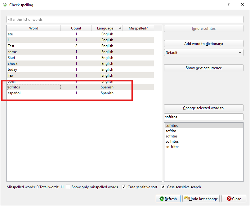

Ever since Calibre added Multi-Language Spellcheck, you can easily mark the words with lang + xml:lang.
Example sentence:
I ate some español sofritos today.
1. Use Calibre's Tools > Check Spelling with Show only misspelled words checked.
Most foreign words should pop up as misspelled. "sofritos" would stick out like a sore thumb.
Use Change selected word to and replace it with something like "@sofritos@".
Note: The very last word in the list is the word itself, so just click on that and make your adjustments:

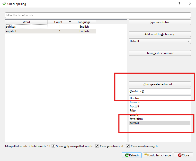

3. Run Spellcheck List again, and repeat Step 1.
You'll easily be able to see which Spanish words you've caught so far, and narrow the list down further:
