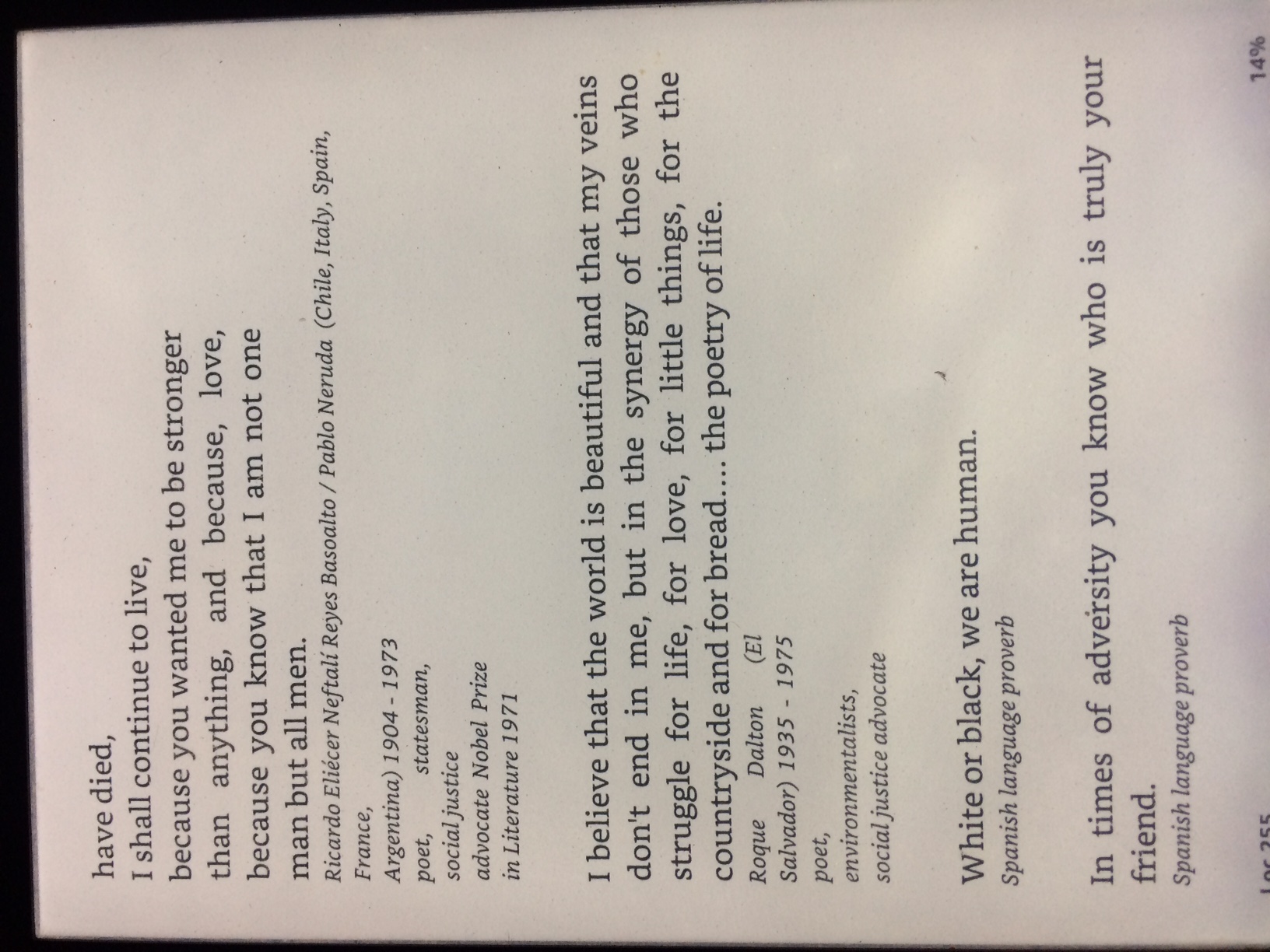

Please forgive this newby question, which I'm sure has been discussed before.
My goal is to transfer my manuscript of quotes for distribution via Kindle.
I first formatted the text and created a pdf that can be used for viewing on the computer.
Following suggestions read on this forum, I then used CALIBRE to convert the rft manuscript to AZW3. The problem is line spacing. Attached you can see:
a. sample from the pdf, with proper line spacing
b. sample from the reformatted rtf, still respecting the line spacing design
c. photo of Kindle screen that shows wrong line spacing.
I do read in the forums that I need to play with the CSS codes for text height and line height to create the design I desire. My questions at this point are:
1. where are these codes in the rtf file? how can I view them? I can see the pilcrows but nothing more than that.
2. what program should I use to try to edit those?
thank you.

What you really want here is paragraph styles, and I don't think rtf is smart enough to support them. If you were using LibreOffice Writer (or Word) you could apply styles there, in the manuscript, and let Calibre convert the odt or docx file. It looks like your azw3 is getting the same style for each paragraph in conversion, at least for spacing.
For the html in the azw3, you want to end up with something like this:
For the main paragraph, something like
<p class="mainpara">your text</p>
With the CSS code
.mainpara {
text-align: left;
margin-top: 1.5em;
margin-bottom: 0;
Then for the subsequent lines,
<p class="subpara">your text</p>
With CSS code
.subpara {
font-style: italic;
text-align: left;
margin: 0;
There can be other codes in there for fonts, or font-size or whatever you want, but the above should make the spacing right. And you don't want empty paragraphs for any spacing, which is likely how the rtf is doing it--the styles will take care of that. And you shouldn't have to mess with line heights for this.

The term is Paragraph breaks.
Line spacing ( applies to many lines within a paragraph block) is controlled by line-height: 1.2 (is normal)
Make sure your conversion settings do not have remove blank lines.
(also, your device may need to use Publishers Stylesheet unless you hard encode blank lines )
FWIW I gave up trying to get a 'perfect' conversion between formats. I hand edit my EPUB/AZW3 to add the FINAL polish

Not into the RTF
AFTER it was converted. Making conversions look beautiful depends on the version. so edit the version, not the source.
BTW If the PDF is good, why make a AZW3? Make an AZW4 (I think the Kindle Previewer will do this for you)

The red and blue underlines in your 2nd image suggest it's an image of Word, or maybe Writer (can't recall if it underlines 'errors' in red and blue) - if so save the file as DOCX and try converting that.
And as previous responders have suggested if you use Styles in Word/Writer you'll get much a better result.
