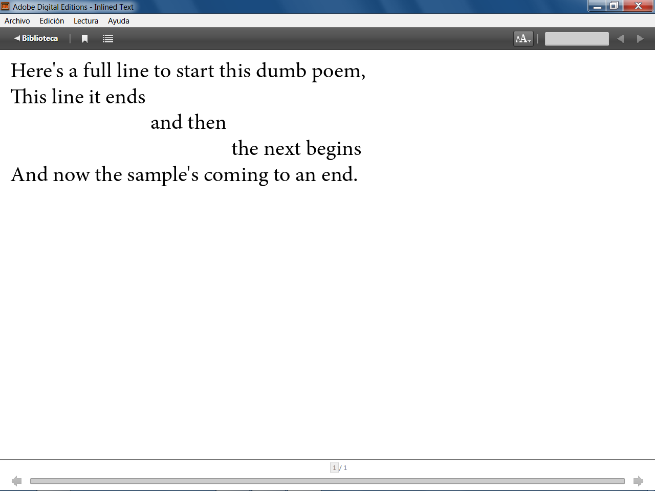

Hi sjfan;
I think you're refering to this post:
https://www.mobileread.com/forums/sh...80&postcount=8
But you can follow this another aproximation:
<body>
  <p>Here's a full line to start this dumb poem,</p>
  <p class="inlined">This line it ends</p>
  <p class="inlined1">and then</p>
  <p class="inlined2">the next begins</p>
  <p>And now the sample's coming to an end.</p>
</body>
and
p {
   text-align: left;
   text-indent: 0;
   line-height: 1.2em;
   margin: 0;
.inlined, .inlined1, .inlined2 {
   display: inline;
.inlined1 {
   vertical-align: -1.2em;
.inlined2 {
   vertical-align: -2.4em;
Below you can see how it looks under ADE:
I attach the respective epub.
Regards
Rubén
