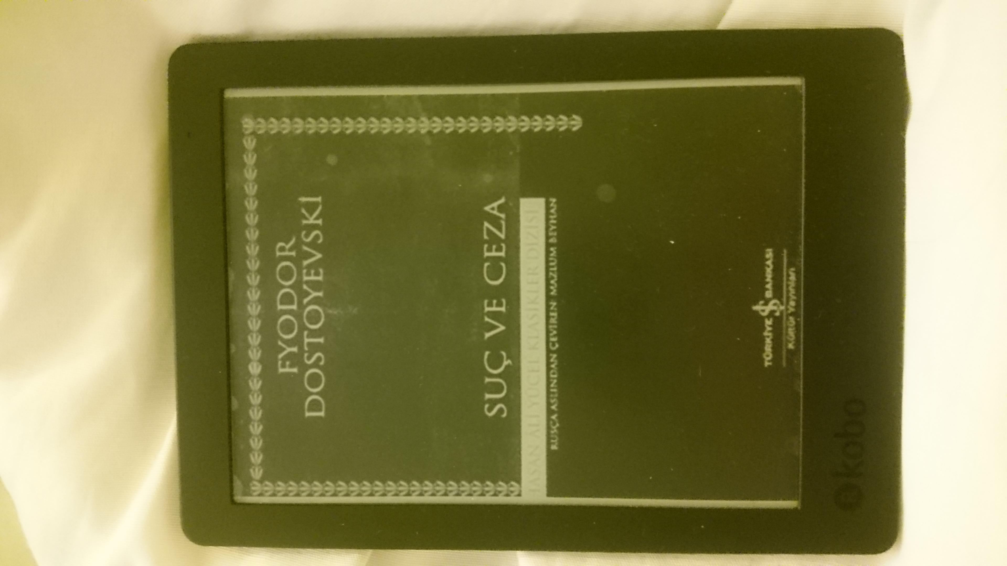

From ksm and after the last update it was working fine. Worst part is hard reset does not work since it does not even turn of for it. It stuck like attached file on sleep mode. The last book that I was reading before this happened

I imagine the Aura SE still has a LED near the power button? Does it react in any way?
Does the Aura SE still have a dedicated reset button (pinhole style), or had they already dropped those by the time this one came out?
How is your KSM setup? (Depending on its setup, it *may* be inhibiting the software "force factory reset" procedure).
