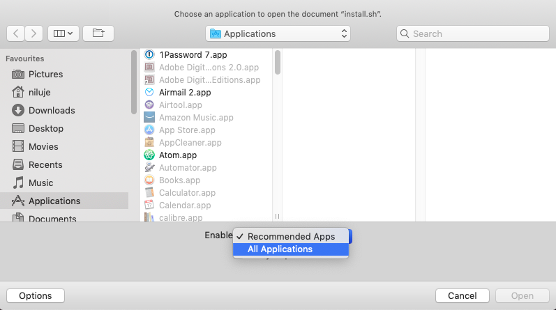

macOS:
  1. Check the previous message, and download the ZIP package that you're interested in, remembering the macOS/Safari quirks I mentioned above.
  2. Download the macOS install script archive, and unzip it in the same folder.
  3. Run the install.command script (Right Click > Open > Then click Open in the GateKeeper popup).
    That should look like this:
  4. Follow the on-screen instructions. Close the window when it's done.
  5. Safely eject your Kobo, watch it process & reboot .
