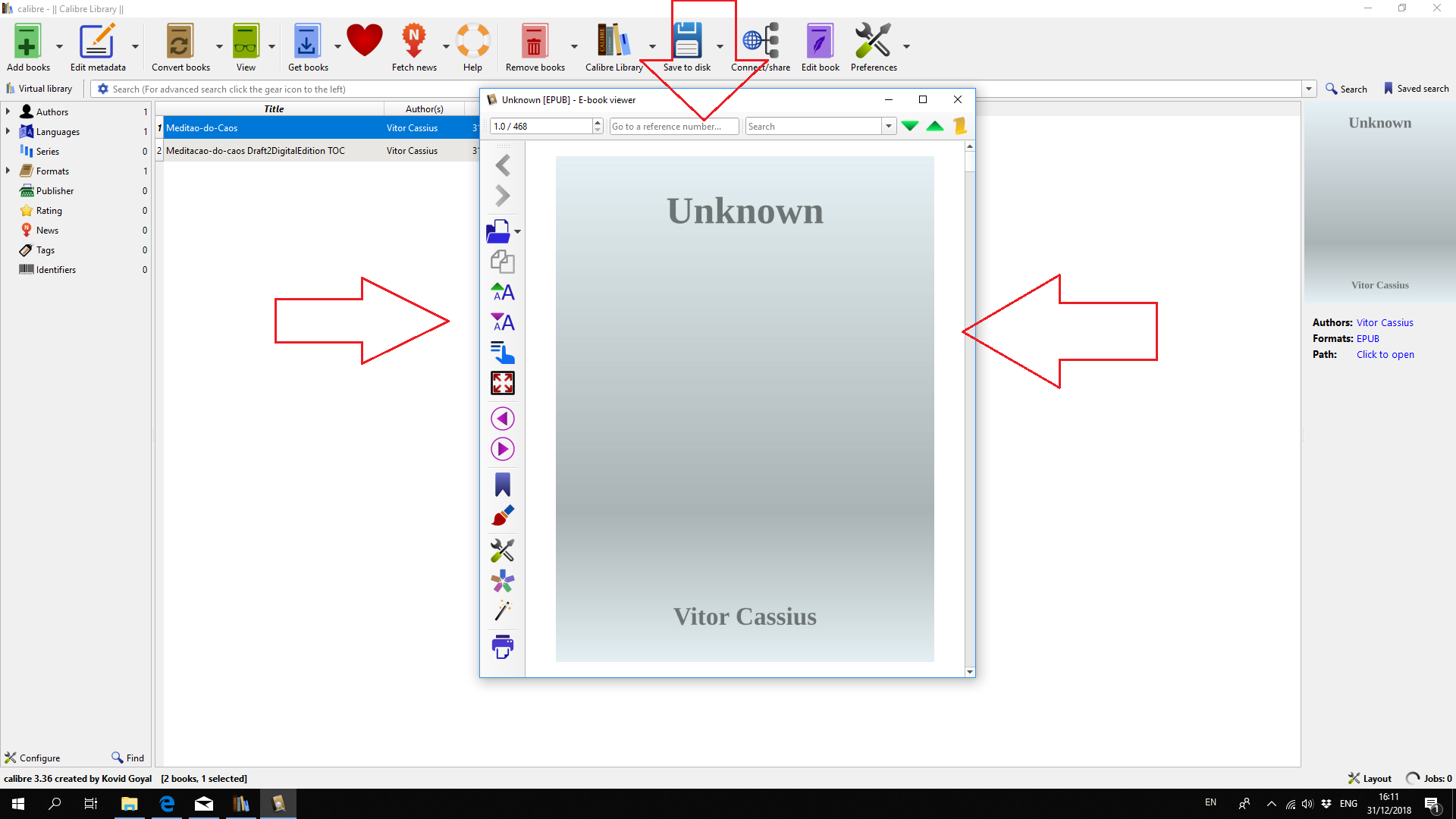

Hi.
every .doc that I convert to epub produces the "first page" below.
(attached file)
I use a online tool to convert.
please, how can I remove that page?
Better, how can I remove any page of a epub individually?

If there is no option to not generate a cover, you are out of luck. Instead of an online tool, I would suggest using calibre locally since that is what most of the online conversion pages use as their conversion engine.
As for removing a page individually? I'd suggest either Sigil or calibre's editor.
thanks, dnsb.
but I believe that Calibre doesn't convert doc to epub
vitor.cassius is offline   Reply With Quote

Originally Posted by vitor.cassius View Post
thanks, dnsb.
There is a DOC Import plugin that will do it. But, if you can save as DOCX, the import plugin is built-in. And probably better.
Old 01-02-2019, 09:23 PM   #5
Posts: 22,085
Karma: 30277960
The calibre Modify optional plugin can remove the cover from an ePub.
