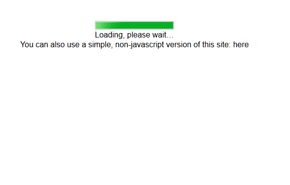

So I am running calibre-server on Linux and can access the content via 192.168.1.1:18080/mobile (example URL), but cannot access without the mobile at the end. Tried in chrome and firefox and am running current versions with JavaScript enabled.
What I get is this:

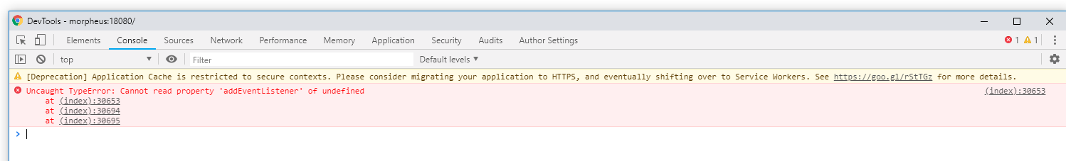

Chrome Devtools gives this:
Any ideas on what may be going on and how to fix here?

Maybe a dumb suggestion: Shouldn't 192.168.1.1:18080 be
192.168.1.1:8080 ?
The default port is 8080 in Calibre.

if it works with the /mobile, he is not using the default port (I sure don't. many other apps also default to 8080 )

Looks like both Chrome and Firefox have restricted AppCache to secure sites only on newer versions (Chrome 70 and Firefox 62). Dunno how to fix short of getting a SSL certificate.
https://developer.mozilla.org/en-US/...ecure_contexts
Maybe try using an older release or FirefoxESR or something?
Old 12-22-2018, 01:09 PM   #5
Posts: 46,517
Karma: 29634066
Update calibre, newer version dont fail when appcache is disabled. Or enable SSL

Sweet - that was the issue.
