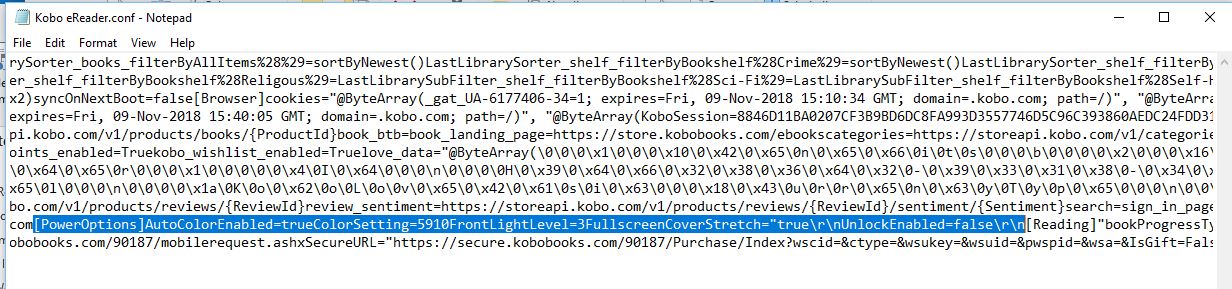

For the UnlockEnabled=false setting, is the file I need to update \.kobo\Kobo\Kobo eReader.conf?
If so, is there a special text editor I need to use because in Notepad it looks like all the text flows together as shown below.
(click for larger image)
When I tried to add a carriage return and put in the UnlockEnabled=false line, it looks like it just added it to the FullscreenCoverStretch entry.
The strange part is when I copy/paste the entries in the file, it appears there are hidden line breaks (expect for the line I tried to add).
[PowerOptions]
AutoColorEnabled=true
ColorSetting=5910
FrontLightLevel=3
FullscreenCoverStretch="true\r\nUnlockEnabled=fals e\r\n
For config files its best to open with wordpad so the text doesnt flow together, or you could install Notepad++.
Yes
[PowerOptions]
ColorSetting=5910
FrontLightLevel=3
This is because windows expects newlines to be a CRLF (carriage return, then newline), and linux (the kobo) expects newlines to be just LF. Basically any text editor but notepad will handle this fine.
Yes
I think Notepad++ is usually advised as the simplest option. I use TextWrangler.
EDIT: Ah fun three posts at once and I lose. Oh well.
Thanks @ReaLx3m @geek1011 @Mrs_Often!
Notepad++ helped me fix the issue.
