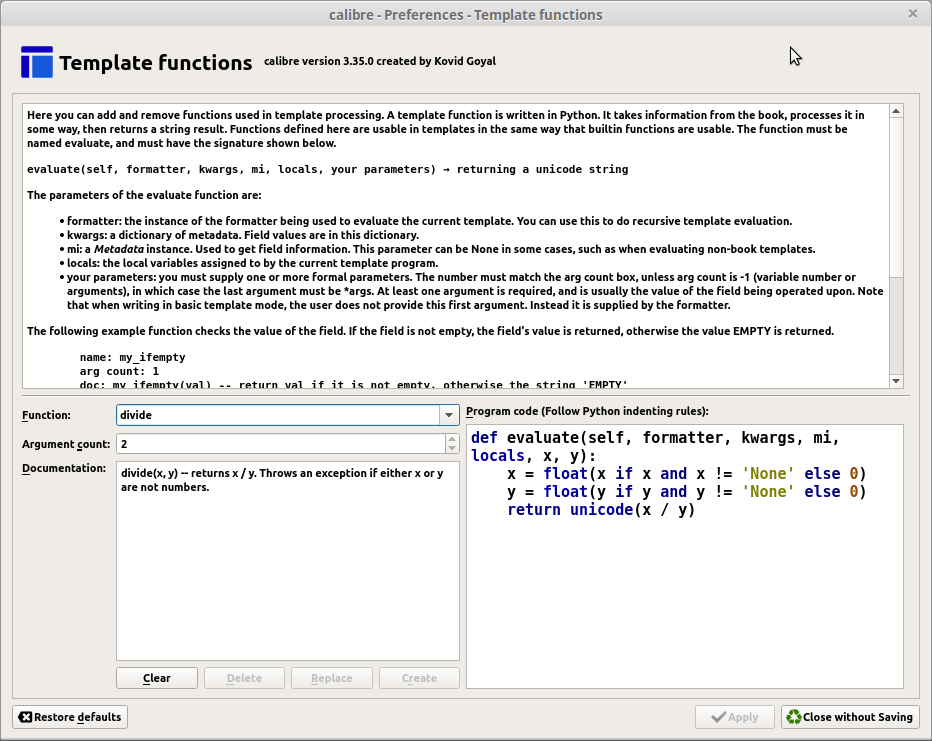

You can use the Template Functions utility.
Name:	Screenshot from 2018-12-10 10-32-32.png
bernie
EDIT
https://manual.calibre-ebook.com/template_lang.html
