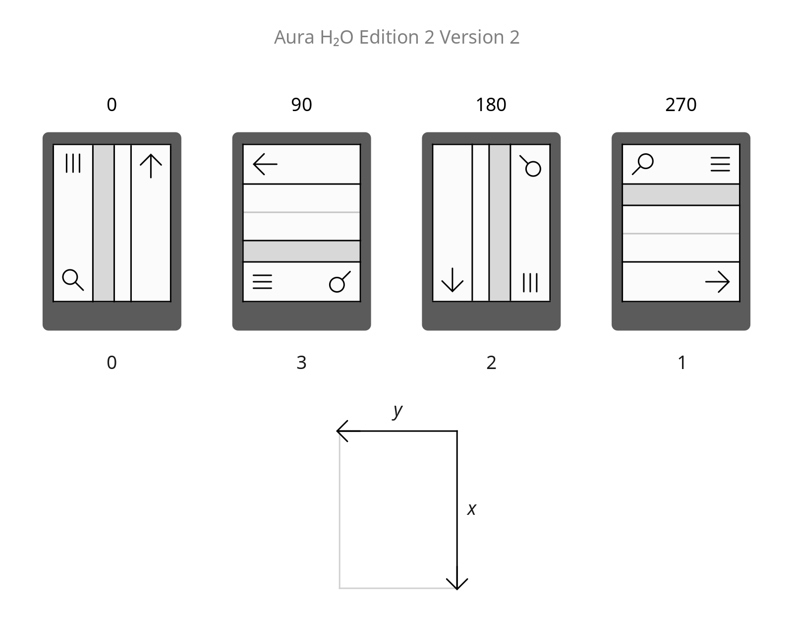

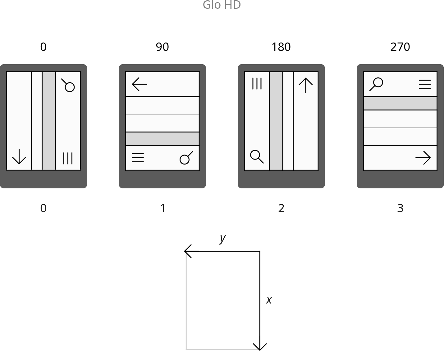

I've attached an example of visual representation that could be used to communicate the required information.
The row of numbers under the devices indicates the read values when the written values are 0 1 2 3. On the Aura H₂O, for example, this row would be 2 3 0 1. The axes of the touch coordinates are given at the end.

Originally Posted by DezReads View Post
0 0
1 3
2 2
3 1
Thanks, those devices are really surprising. One last question: what's the initial rotation value?
Please checkout the attached rotation card for your device: it should match the description you've given.
For the people interested in the mathematical details, the touch transformations for this device are:
0 → Mx My
1 → Sxy My
2 → Identity
3 → Sxy Mx
Which means that the center of the mirroring pattern is not sufficient anymore, we also need to know if Mx comes after or before Mx My (modulo 4).

My bad, that holds for the fb, NOT the touch axis . My top-left corner touch example is at (61, 1026).
The touch axes should be the same, otherwise you would have noticed inconsistencies. And the coordinates you gave for the top-left corner are in accordance with the touch coordinates of the Glo HD: x is small and y is big.

@baskerville: Yeah, no, it works, I'm just confused by the direction of the axes in your graph . The origin is indeed the top-right corner, but the inverts & mirrors are breaking my brain ;p.
