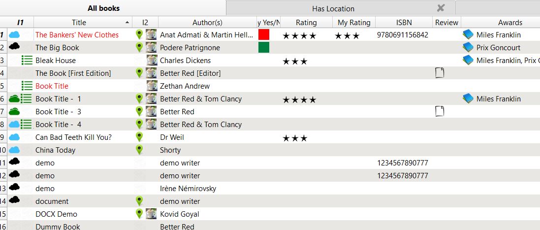

Yeah, that's using calibre's column colouring feature - my brain isn't very good at associating colours with a semantic states - apart from the state of my bank balance
Here's a sample of calibre's column icons feature from my test library
