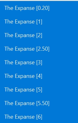

I have a collection on my Aura H2O2 and I cannot get it to list in series order.
There are 9 books in the collection, and the order they are listed in is
0.2
2
2.5
3
4
5
5.5
6
1
I have tried updating the series order for the whole series 3 times, and for book 1 twice. Each time I am careful to make the book(s) is/are highlighted, and select "update metadata in device library. Then I eject the device check the collection, and run it again. The first time I did this, the plugin showed a non-zero result for "books changed" Every subsequent attempt, no books have been changed and the series order persists in being almost perfect, except for having the first (published) book listed last. What am I doing wrong this time?
Old 11-29-2018, 07:28 PM   #1540
Posts: 32,055
Karma: 65709392
I suspect there is a invisible character in front of that 1 .
Use the Metadata editor to set it different using the scroll arrows, then back to 1

Old 11-29-2018, 07:41 PM   #1541
stuartjmz
Nameless Being
Thanks for the suggestion. When I checked the series metadata in calibre, it said "1.00", so I used the sroll buttons to go up to 2.00 then back down to 1.00. I then ran the plugin twice, once on just the one book, then again on the whole series. No change in the listing. FWIW, here's how the series lists in Calibre
Old 11-29-2018, 09:26 PM   #1542
davidfor
Posts: 24,905
Karma: 47303828
Location: Sydney, Australia
0.2
2
2.5
3
4
5
5.5
6
1
The series sorting on the device is not done just on the number. It is the combination of the series name and the number. What is probably happening is that the series name isn't quite what you think it is for that books. The series sorting in calibre uses a series sort value that is hidden and calculated when the series is set for a book. And the plugin is using the series name to populate the database on the device. There are a few things that could be causing the difference in sorting. The language of the book is one of them.
What I suggest is to remove the series info from the book, connect the device and update the series on the device. Then disconnect and check what is displayed. Then set the series info on the book and do the update again. That will probably fix it.
If it doesn't, I need to see a debug log. Run calibre in debug mode, do the series updating and then post the log. The log should show me what has happened.
Also, if updating the series info is the only thing you are doing, you can let the driver do this. By default, the driver checks the series info every time the Kobo devices are connected and makes any changes needed. You can turn this off if you don't want it, but using it means you don't need to do it manually. I don't think there is a difference in how the driver and the plugin set the series index.
And the next version of calibre will have an update to the driver to automatically update the rest of the metadata that the Kobo devices use and display. That will be off by default, but if you turn it on, you won't need to use this plugin anywhere near as much. It does have a performance hit, but mainly when there are a lot of changes needed.
davidfor is offline
Old 11-29-2018, 10:04 PM   #1543
stuartjmz
Nameless Being
When I did that, Leviathan Wakes disappeared from the collection on my device, as I expected
When I did that, Leviathan Wakes reappeared listed as book 1, in last place again.
I repeated the process in debug mode and the first time Leviathan Wakes disappeared from the collection even after re-entering the series info. So I did it again, all still in debug mode, and it returned, in last place. What I forgot to do was note the path of the debug log sorry! Before I try anything else, where can I find the log to post here?
Found it

Old 11-30-2018, 12:11 AM   #1544
davidfor
Posts: 24,905
Karma: 47303828
Found it
If you close calibre when finished the tests, it displays the log for you. That is what I usually tell people if I need to give instructions for running in debug mode.
Looking at that, it should be correct. The log is showing that it is setting the series name and number to the expected values. But, it might not be this one that is wrong. Maybe the others are the problem. Could you run in debug mode and do an update on all the books in the series. You don't need to make any changes, just select them and run the update. The log will show me what is on the database and in calibre. Maybe I will see it.
But, for the record, I did think of a fun little problem. If the number of spaces between the "The" and the rest of the name is different, you get some interesting results. Calibre will treat "The Expanse" and "The Expanse" (several spaces) as different series, but will sort them all as "Expanse, The". Which means they get mixed together. You can probably see this in the lists, but it might not be that obvious depending on the font used and font size. And if some other type of space was used, it might not be visible. I don't know what would happen on the Kobo devices with this.
davidfor is offline
Old 11-30-2018, 12:49 AM   #1545
stuartjmz
Nameless Being
To eliminate the possibility of an extra, unseen, space, I did a bulk metadata edit, forcing all of them to be "The Expanse". I then renumbered them all, connected the device and ran an update. The result was the same as previously. Then I ran it in debug mode and tried another series update. No change.
