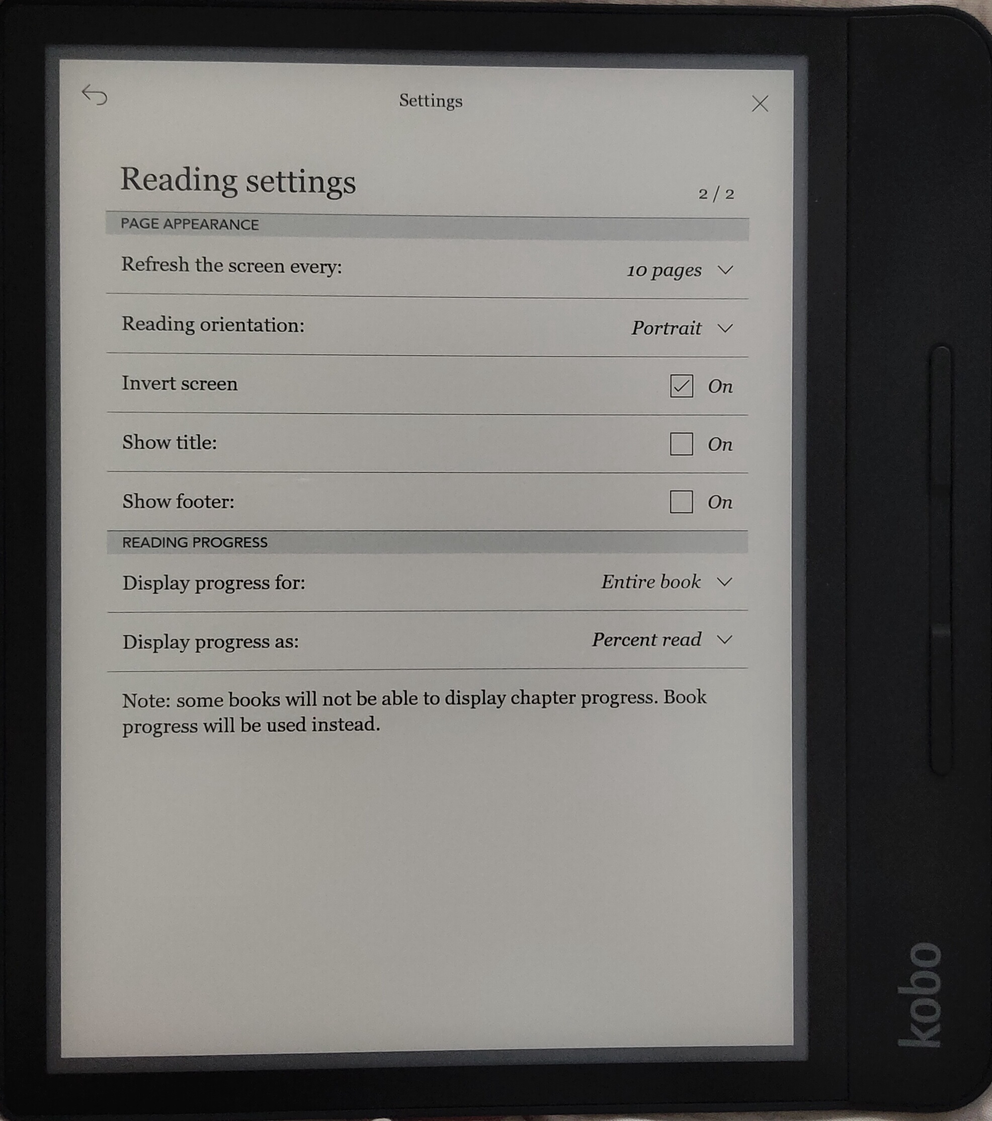

Hey, @geek1011, I found a bug of "Replace adobe page numbers toggle with invert screen".
I put
[DeveloperSettings]
EnableDebugServices=true
into "Kobo eReader.conf" and enable "Invert Screen" in Settings->Developer options(The "Invert Screen" in "Reading Settings" is unchecked), and it works perfectly even after I power it off/on again, the status will keep as I set in "Developer options".
But if use this "Invert Screen" patch and enable it in "Reading Settings" (before enabling this patch, I disable/uncheck "Invert Screen" in "Developer options" and remove the above lines in "Kobo eReader.conf" and power off/on): it works OK, once I power it off/on again, the effect will be gone, the white-text-black-background effect will restore to the white-background-black-text, but the status of the "Invert Screen" item in "Reading Settings" is still what I set (on/check status), so if I want it white-text-black-background again, I have to uncheck-check it again.
This bug can be reproduced. I've tried it multiple times.

I can't seem to reproduce this on my Aura Edition 2. Could you post some screenshots?
Please check the attachment, "Invert Screen" is on in "Reading Settings", but the screen is while-background-black-text. I took this picture after powering off and on again, if I don't power off and on again, "Invert screen" in "Reading Settings" works fine.
How can you have "show title" and "show footer"? Are they build-in features only available for Forma? Or what patch you have used?
