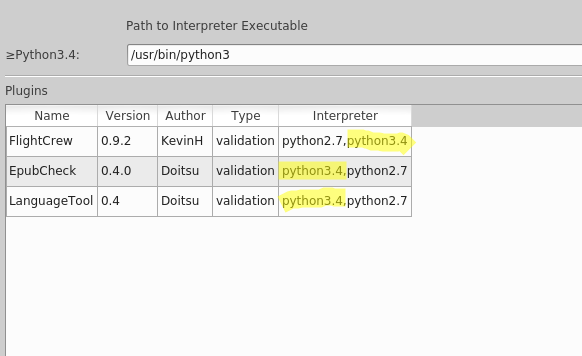

And I just noticed this in the Sigil plugins (screenshot). Doesn't that mean I have 3.4?
Diap, even if I have 3.4, if I don't select "bundled" there is no "external python" to select. So what do I do?
No. It doesn't. That doesn't have anything to do with what's installed on your system.
Python3.4 is the minimum Sigil needs to function. You meet that minimum. In fact, it looks like you have Python 3.5 -- which is perfectly fine
You click the "Auto" button in "Manage Plugins" to let Sigil find a suitable Python 3 interpreter for you. If it's unsuccessful, you use the "Set" button to browse for the Python 3 executable manually. It's usually something like /usr/bin/python3.
