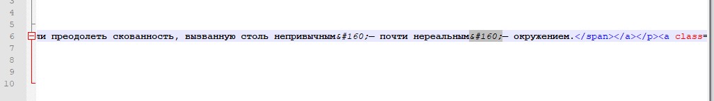

When I use kepubify, I drag and drop the .epub file onto kepubify.exe into windows, as a result the non-breaking space character & #160; is added to the .kepub file. Because of it, Russian hyphens work incorrectly in my kobo - the last letter is transferred to the next line. Can I avoid this?
I would need to see the original epub file to figure this out. Can you PM or email it to me?

I received your PM. The issue is that the spaces are actually non-breaking spaces. See the screenshot (I searched for ordinary spaces).
The reason why the book worked fine before the conversion is because some parsers would ignore that was, as it should be escaped. Kepubify will try to make non-compliant html compliant (and as a result, converts nbsp chars to their escaped equivalent).
