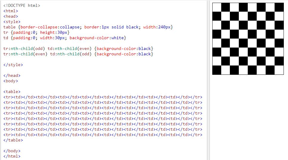

If you have a device that supports nth-child selectors you can make this reeeally easily...
<!DOCTYPE html>
<html>
<head>
<title>Chess Board</title>
<style>
table {border-collapse:collapse; border:1px solid black; width:80px}
tr  {padding:0; height:10px}
td  {padding:0; width:10px; background-color:white}
img {width:10px}  */ with Square image /*
tr:nth-child(odd) td:nth-child(even) {background-color:black}
tr:nth-child(even) td:nth-child(odd) {background-color:black}
</style>
</head>
<body>
<table>
<tr><td></td><td></td><td></td><td></td><td></td><td></td><td></td><td><img src="bk2.jpg" alt=""/></td></tr>
<tr><td></td><td></td><td></td><td></td><td></td><td></td><td></td><td></td></tr>
<tr><td><img src="wk2.jpg" alt=""/></td><td></td><td></td><td></td><td></td><td></td><td></td><td></td></tr>
</table>
</body>
</html>
If you don't, then you can use your technique, but make sure you have the proper quotation marks around the src="pieces/b.jpg" alt="" (you don't need alt=cp).
You can get rid of any styling in the table itself. Simply give it a class and then put the proper (to your taste) styling in the linked stylesheet. See example for possible css.
Cheers,
edit: I think your extra lines came from the spaces (line breaks) you had between the <img> tags.
