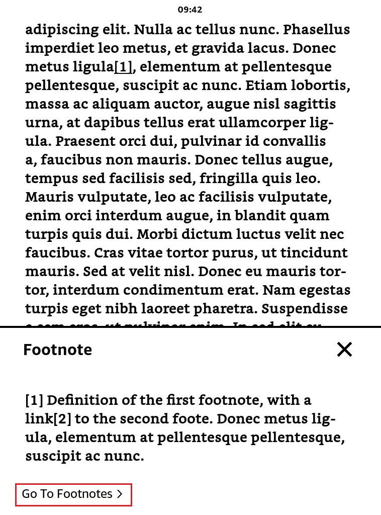

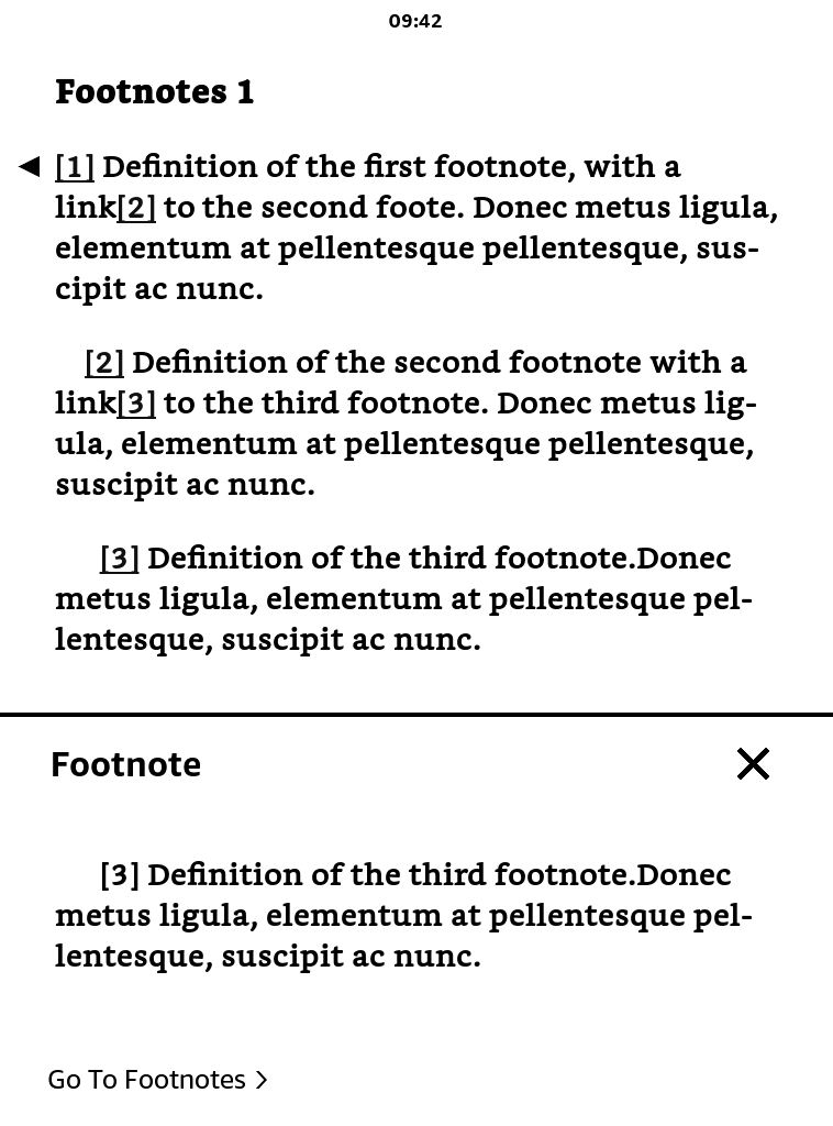

To see this in action, look at the file attached.

Obs.: When you put the ID inside the link element (<a>), Calibre will threat it like a pop-up footnote, wich is great in most cases, but can be problematic in your case, with nested footnotes. To avoid this, I placed the ID inside the paragraph element (<p>) or SUP.

BTW, different apps/devices render footnotes differently. For example, iBooks requires footnotes to be properly defined, while the Kindle firmware (or KindleGen) uses heuristics and will usually display back-linked text as popup footnotes.
This works great for non-nested footnotes, however, if footnotes are nested, users usually can't tap links in footnote popup windows to display sub-footnotes.
I've created a simple epub3 test file with two different footnote sections.
The fist topic contains a link to non-nested footnote definitions:
  <div class="footnotes">
    <div epub:type="footnote" id="fnid1" role="doc-footnote">
      <p class="endnote"><a href="../Text/test.xhtml#fnref1" title="footnote 1">[1]</a> Definition of the first footnote, with a link<a epub:type="noteref" href="../Text/endnotes.xhtml#fnid2" class="footnote" id="fnref2" role="doc-noteref">[2]</a> to the second foote. Donec metus ligula, elementum at pellentesque pellentesque, suscipit ac nunc.</p>

while the second topic contains a link to nested footnote definitions:
      <p class="endnote"><a href="../Text/test2.xhtml#fnref1" title="footnote 1">[1]</a> Definition of the first footnote, with a link<a epub:type="noteref" href="../Text/endnotes2.xhtml#fnid2" class="footnote" id="fnref2" role="doc-noteref">[2]</a> to the second foote. Morbi dictum luctus velit nec faucibus.</p>
      <div epub:type="footnote" id="fnid2" role="doc-footnote">
        <p class="endnote2"><a href="../Text/endnotes2.xhtml#fnref2" title="footnote 2">[2]</a> Definition of the second footnote with a link<a epub:type="noteref" href="../Text/endnotes2.xhtml#fnid3" class="footnote" id="fnref3" role="doc-noteref">[3]</a> to the third footnote. Morbi dictum luctus velit nec faucibus.</p>
        <div epub:type="footnote" id="fnid3" role="doc-footnote">
          <p class="endnote3"><a href="../Text/endnotes2.xhtml#fnref3" title="footnote 3">[3]</a> Definition of the third footnote. Morbi dictum luctus velit nec faucibus.</p>
        </div>
      </div>
    </div>
  </div>
(I used <div> instead of <aside> for backwards compatibility with epub2 readers.)
iBooks will display only the first footnote definition, if the definitions aren't nested. If they're nested, it'll display the footnote definition and all nested sub-footnote definitions, however tapping links in the popup window doesn't work. iBooks also seems to ignore styles in footnote popup windows.
eInk Kindles ignore nesting levels and will display only the first footnote definition. Users will need to tap Go To Footnotes to display sub-footnotes. However, if a sub-footnote link is tapped, its definition will be displayed in a popup window.

Side Note: Long story short, Footception is not a good layout. See discussion about this on the LaTeX Stack Exchange:
Footception? Really? You're killing me here. :-)
For book design/readability... it's almost always bad, bad, bad! And trying to hack this together in Word... atrocious, atrocious, atrocious!!!
Well...in print, it would be relatively simple; you could indent the sub-notes. Perhaps that's the answer here? Altho....thinking about the "how" of how you'd do that. (Maybe indented bulleted notes?)
Alcuin7 PMed me his DOCX, so I was able to take a look at it directly.
I stripped his DOCX down to a page and attached a sample DOCX:
Attachment 167980
Note: ... and as expected, the numbering on his manually formatted "footnotes within footnotes" couldn't cope. ANY sort of adding/removing of footnotes is going to bamboozle the manual "level 2 footnotes".
