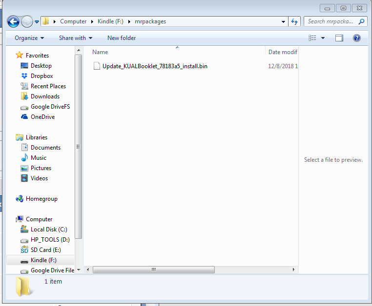

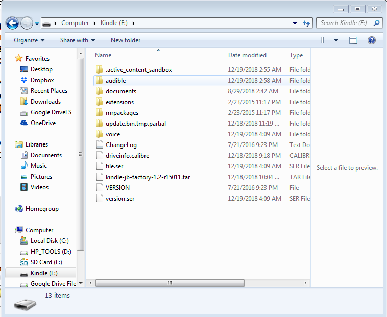

@NiLuJe:
First of all, thank you so much for all of your work and development on jailbreaking Kindles - it is appreciated more than you know!
I got a Kindle Paperwhite (FW: 5.10.0.2, Serial G000 T610...) as an early Christmas present, and am working to Jailbreak it so that I can use Calibre's Collections Manager to manage collections. As far as I can tell, I've successfully jailbroken the Kindle (is there any way to verify this?)
I also installed Mobile Read Package Installer (per https://www.mobileread.com/forums/sh...d.php?t=203326) fFrom what I can tell it was just unzipping the file and copying it to the root of my Kindle.
Next, I'm trying to use ;log mrpi to install the correct KUAL package, which I found here (https://www.mobileread.com/forums/sh...&postcount=304) - it's the new coplate booklet version.
I've dragged the .bin update file into the mrpackages folder, then I go into the search bar and type in ;log mrpi
but then nothing happens. No kindle restart, nothing. No KUAL doc in My Library.
Am I doing something incorrectly? Any thoughts or guidance on next steps?
Thank you in advance for any insight you could offer!!
Your device isn't jailbroken yet. It would have a You are Jailbroken txt file in the documents folder if jailbreak had succeeded.
Note, you're not supposed to copy the kindle-jb-factory-1.2-r15011.tar file to your Kindle directly. You need to extract that tar file first and copy main-htmlviewer.tar.gz to the Kindle root. Pretty much all the tar.xz packages on NiLuJe's snapshots, you have to extract twice on Windows if using 7-zip.
Dunno about WinRAR. I'm using an old version that doesn't support tar.xz archives.
