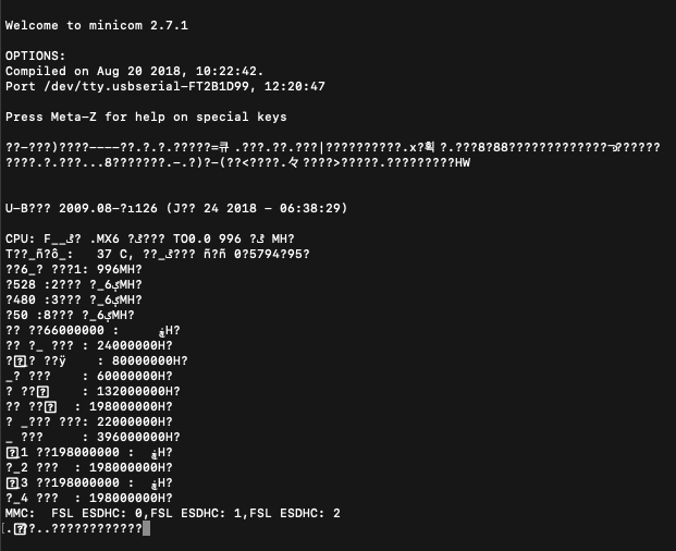

I have already installed the serial cable, and the only thing that has come out is what you see in the attached image, I have tried again, and nothing comes out
What have I done wrong?

That is called: "line noise".
Poor ground connection(s).
  • I have connected the ground to another point, and I have restarted, and I have a prompt to start session (in which I tried to root:fionaXXX and it has not worked), the weird thing is that I did not have to put bootm 0xE41000 or anything, because the only thing that has come out has been the option to start a session, Now what's wrong?
EDIT: I have reassembled everything, through a breadboard, and now if I have seen the U-Boot log, but in half it has been put back with strange words, which is the best place to make land? (for now I have it on a screw)

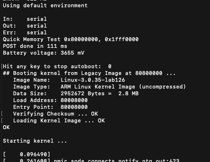

When it reaches the step of 'Hit any key to stop autoboot', I press many keys to stop it but it does not respond, I've tried it like 10 times... do you think the problem is in my TX connection?
EDIT> problem in TX connection, now is working.
