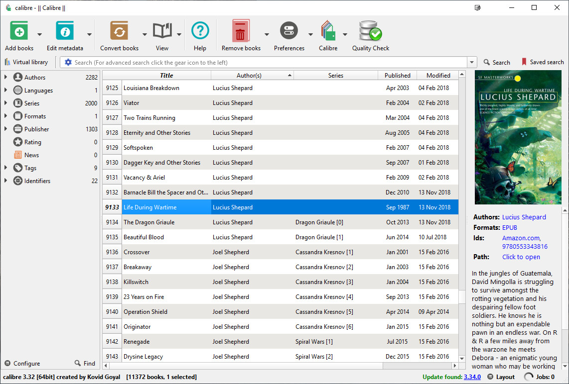

This might help:
Moderator Notice
Pleas follow forum guidelines on inline images. Use an attachment
You can see that Life During Wartime is out of order...it should be up off the top of the screen.
There are a few books like that. And I can't figure out what in them is triggering this behavior. I know it's not in the name, because I changed the author name on all the Lucius Shepard books using the bulk change feature, so they're all identical. Plus, the problem only shows up when I sort by series as well as author and date.
