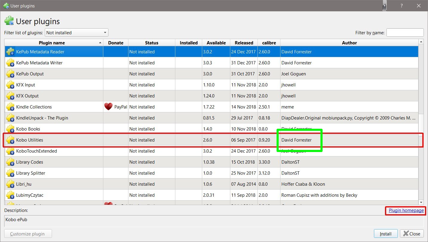

Posts: 22,069
Karma: 30277960
Originally Posted by bookaho!ic View Post
who makes the plugin and is it safe as i clicked on it and it gave a warning saying plugins may contain malware?
That's a calibre standard warning.
As to 'who makes it?' ==>> Click image for larger version
Old 11-14-2018, 08:27 PM   #9
davidfor
Posts: 24,905
Karma: 47303824
Location: Sydney, Australia
I did say "my" Kobo Utilities plugin. And as BR said, that is a standard warning and there are similar warning from other software when installing it. It is potentially true. But, the plugins available through the plugin installer are all posted to threads here on MR. The source is contained in them for anyone to examine. I think that if any of the plugins contained malware it would have been discovered.
