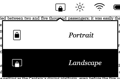

Patches v25 with new "Enable rotation on all devices" patch
I have released v25 of the patches with a new "Enable rotation on all devices" patch by me, and kobopatch v0.10.4 (now shows line numbers for errors)
Line numbers:
They look like "Error: i##: whatever". Just count the number of dashes (instructions) in the patch with the error to find the line.
Enable rotation on all devices patch
I have finished a patch to allow landscape rotation on all devices. This patch works perfectly without any glitches at all. It's actually surprisingly useful for reading certain things. I did this by replacing the check in MainWindowController::allowLandscapeRotation with a MOV r0, 0x1, which is called when building the status bar, and in the different views. Currently, this is all I need to do, as the code to enable the MMA8652 sensor has it's own check, so it won't attempt to enable a sensor which doesn't exist. See the screenshots to see what this looks like on my Aura Edition 2 v1.
